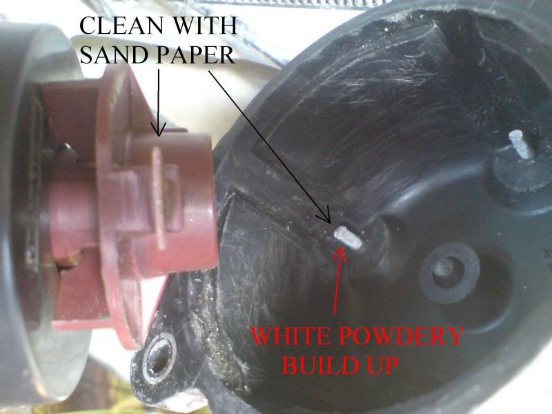

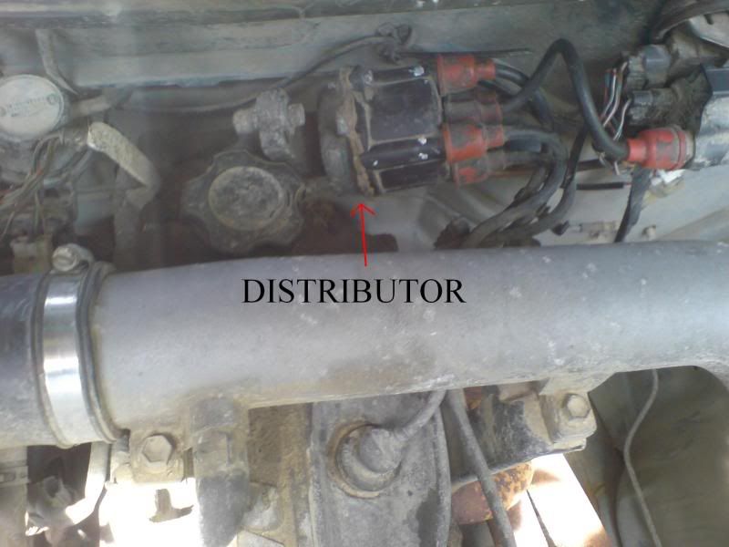

Hi all,
I have a 90ish Escudo with the G16A 1600cc 16valve engine. It has a problem where it runs ok for a while up to about 15mins, then it starts to miss, this gets worse and worse, it looses alot of torque, it gets progressively worse until it is barely drivable (you have to rev it up lots then let the clutch out slowly and it will still bog down and stall frequently.)
We have found that if we take the distributor cap off and lightly sand the copper tip of the rotor arm and the points in the distributor cap that the Suzuki will run fine for another 15mins or less, then the same problem starts all over again.
Some times when we go to sand these points they will have a fine white powder crystallized on to them. This problem happens in perfectly dry conditions as well as when the distributor could have got water in it. Originally we thought that the distributor could have been doing this because it was wet, we have tried to silicon it and it does not seem to have made any difference.
Any help would be great as we all love this vehicle and want to get back out into it :D

I'd start with new rotor and cap, because you have repeatedly sanded the contacts the gap will be too big for the spark to jump across cleanly, which causes that white build up

You have already pretty much pinpointed the issue, it's an ignition problem. Without going into any exact diagnosis, looking at the pictures your cap, rotor, leads, coil and probably your sparkplugs are likely to be a bit on the 'dodge.
