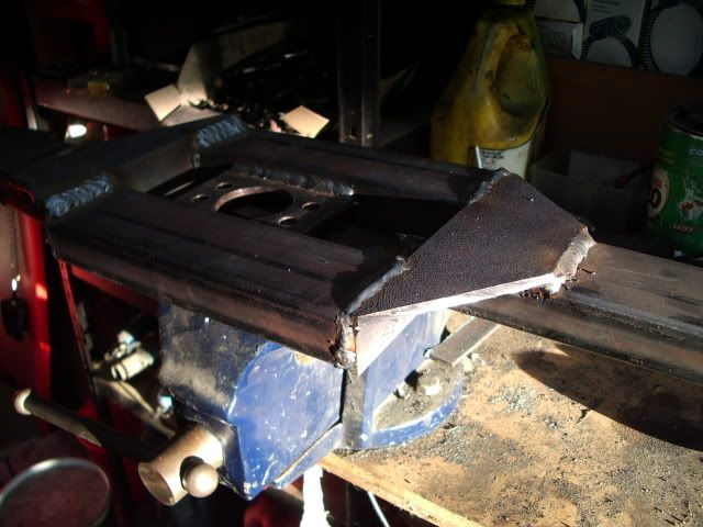

Post by Dace »
UPDATE!!!!

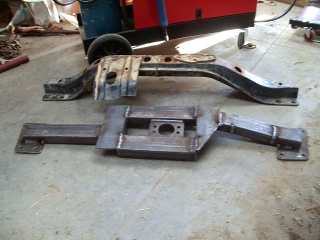

Well , its been a while, trying to figure out how to fabricate a new trans cross member, that lifts the trans 50mm higher, and minimize drop below the chassis rails
well, its now all most ready, have welded most the crossmember to final condition, just lettin the welder and work cool down then will finish it off
pics coming very soon

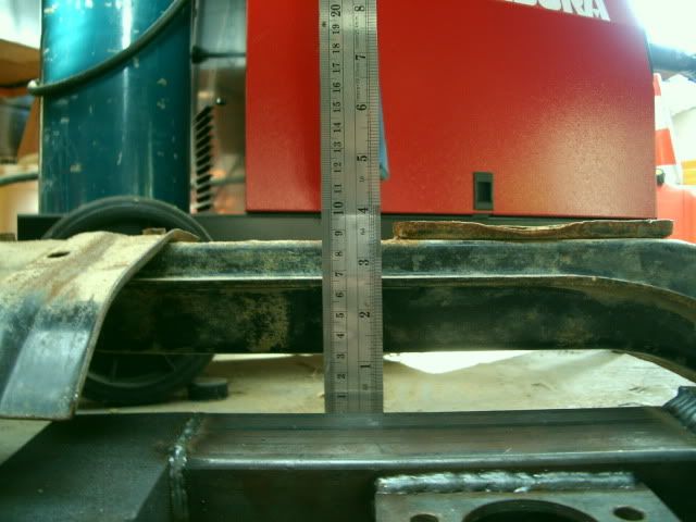

Pics!!!
100mm difference in profile!!!

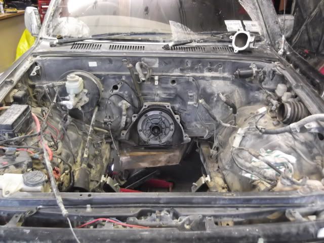

Finally, some more progress
front susp and Diff was reassembled a while ago so truck could be moved, and have spent last month gettin my new shed setup and lighting sorted. But now that is done, work progresses!!!

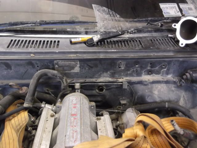

Today, removed the front diff again, with tyres still attached, didn't make it as easy as I would have thought :oops:
have marked the firewall where it needs to be "adjusted" to clear inlet

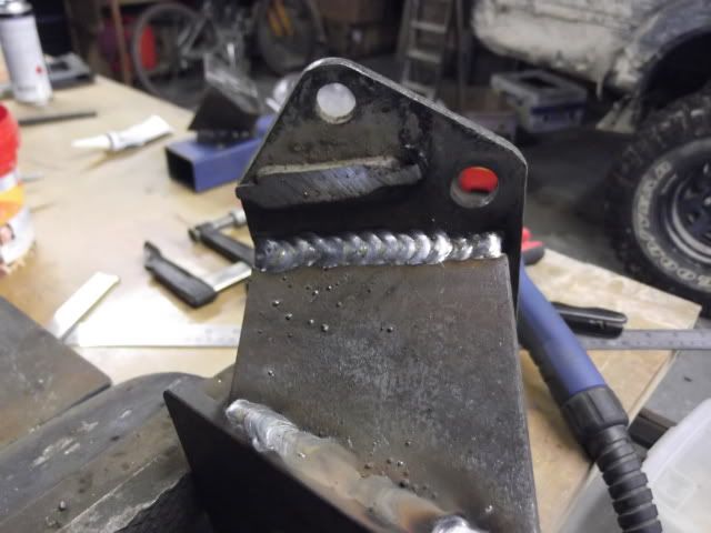

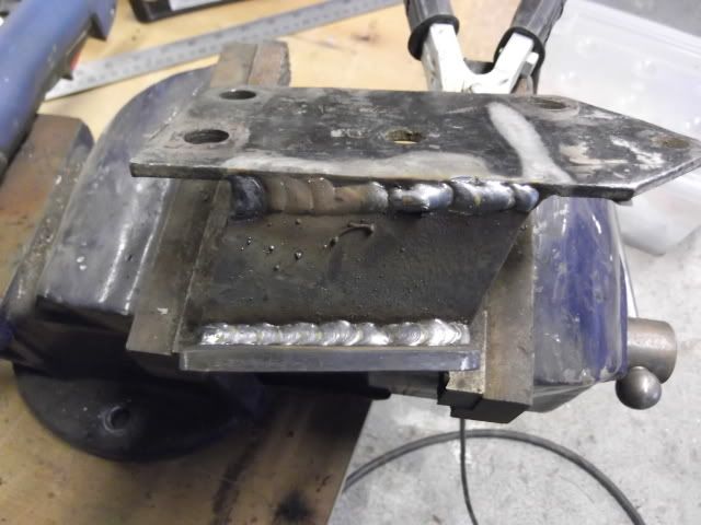

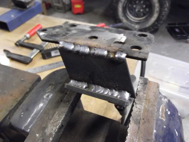

Then pulled the engine out
removed the engine mount I had tacked up in the engine bay and welded them up proper
and that was it for today
next step, drop the trans out and remove crossmember for clean up and take to certifier for his ok.
then, finish the trans-tunnel welding and make patches to cover the holes (who would have thought that a VN commy tunnel wouldn't bolt into a LN106 :roll: )
and clean up the engine bay, remove unneeded brackets and relocate brake line above body seam.
more to come soon

More progress....
Taken the engine mounts and trans crossmember to cert guy for his ok, which I got :D
have cut, "adjusted" and rewelded firewall for clearance to throttlebody, and modified the passanger side heater pipe for same reason, has come out better than expected, should have heaps of clearance.
have done some more trimming in the transtunnel and now just need to start making some panel patches to fill the gaps
have removed both the front springs and hangers and am preping to cut of the existing front mounts in anticipation of movin em 50mm lower for rear to front conversion
