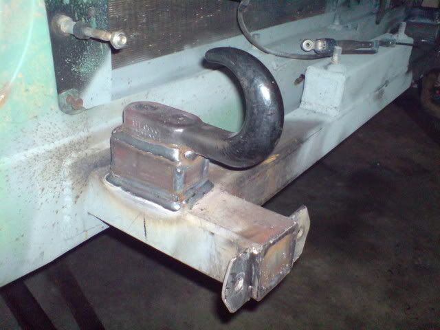

dazza85 wrote:Image
turoa wrote:To be honest, if you asked me for a tow, i would probably reject your request. I have been told that the general rule of thumb is that 1" of weld will hold 1 ton. A tow hook is what? 2" long. This means that there is only 4 tons worth of strength holding that hook on. A decent snatch will put more than 4tons of strain on it.
Also it will put alot of leverage on those bottom welds of that box. Nice welds though.
I'm with him ... the whole leverage thing because of the spacer alone would make me me think twice ...
The things to consider are how is the hook mounted - bolts welds etc and what is it mounted to
there are a couple of pics on here somewhere that show welds that have let go - the hook was bolted onto a small plate that was welded onto something else

geckoadventure wrote:
dazza85 wrote:Image
Since I am not a fan of open hooks since one peeled the bonnet of my 80 open several years ago during a simpla snatch out I would have to leave you stuck. 1600 kg in thick mud is over 4000kg of pull to extract.
As a rule of thumb I would not be snatching a NIVA same as I do not snatch any monocoque vehicle only winch. Recently I pulled a bullbar of a XJ JEEP haha his fault his winch died and my REDs truck WINCH is a bit powerful.
I would also not be winching or snatching this truck. 1 its welded the hook to the tube and hence has too much leverage. 2. its a open hook. I prefer closed hook/shackle after having a OPEN (note poor quality also) hook break once on a snatch and having the bonnet of my 80 opened up like a tin can with a broken hook flying back of a very long snatch strap and yes we did not have a dampner. The hook hit the rubber on the window and saved both our lives as it flew 40+feet into the air and landed behind the 80 with the snatch strap leaving marks all over the window and bonnet and wrapped around the ariel mount wihoch also saved both of us.
A winch is more able to be controlled than a snatch.
