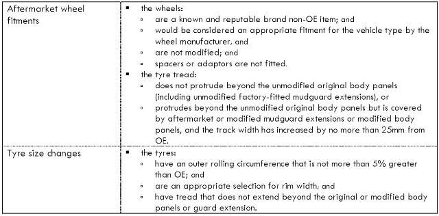

Low Volume Certification Not required if you meet the following Criteria. (From http://www.lvvta.org.nz/)

My Safari failed wof with landcruiser offset rims in 16x7", dont even stick out past the flexi flares but the wheel track width, (eg. centre of Left wheel to centre of right wheel) was 5mm too wide, had to cert lift so didnt make any difference but still pist me off,im mean come on! 5mm!
