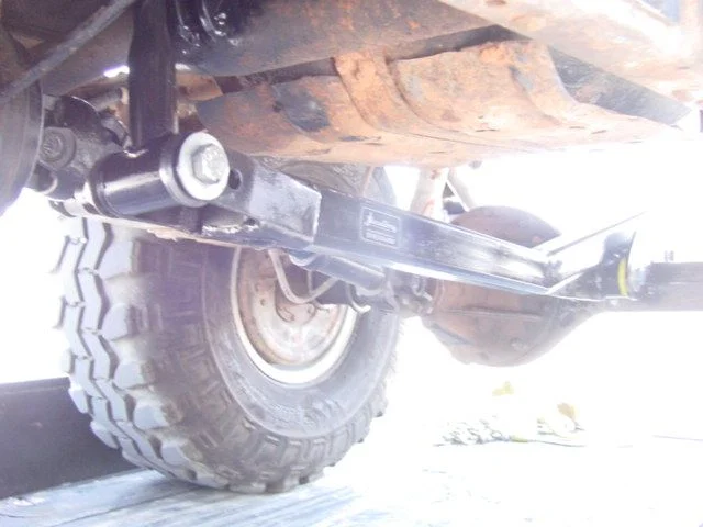

Sadam_Husain wrote:
Bulletproof wrote:Hi Marty
Dont you have a solid 12mm piece of vertical steel welded on to strengthen the spring Perches ?
My perches did that also so I beefed them up.
Cheers Richard
Yeah Howie made some new spring perches for it out of some box sextion with the ends capped off to strengthen them up... not sure what will bend or break next? I've got a pic somewhere but it takes hours to find it on photobucket on my dialup connection :oops: :mrgreen: :mrgreen:
I think Marty is talking about these photo's
Before Howie got it...
After Howie sorted it....

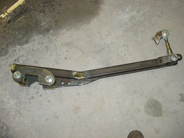

interesting thread. Liked the box section bar work.
Also found the comments re where bars meet at front end where he says his first setup bent. And how both bars should meet at the same point for extra strength. Funny that. Cause mine has bent. So I might get mine made same as his second attempt. Thanks for that fakey.

That's an awesome link - Cheers,
I like the look of this option:
But I'm starting to think that for the amount of work involved I might as well just coil the rear as well...

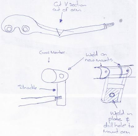

OK, so lets see how well you can translate my crazy thoughts... I've come up with an idea :roll:
I have an old trailing arm (from a front 3 link suspension set up) that has a bolt end (instead of an eye end which would suit a shackle).
Plan is to cut the arm to similar shape as below pic and mount to diff in same location and fashion...
For the mount to the cross member I will use a shackle (with swinging shackle mounts on cross member to allow forward and back movement) but weld in a plate across the bottom of the shackle - drill a hole in the plate to mount the end of the trailing arm pin through...
Yes, I know I am an amazing artist :lol:
This set up should allow horizontal forward and backward movement (for whole diff moving up and down), and left and right movement (for articulation) but would not allow the pin end of the arm to move up and down - which would stop rotation of the rear diff.
Please someone let me know if my logic is flawed or if I have misunderstood how the above bar works... :oops:

sounds good fella..
carry on.. :mrgreen:
rokhound
Posts: 2558
Re: HELP - explaining correct positioning for Anti-tramp bar
Post by rokhound »
You will have to brace the snot out of that mounting point on your cross member (all that rotational force has to somewhere).
Have a go and try it, worst case scenario is that it won't work as well as you had hoped, but you will know what to do different next time :wink:
Best case, it will be all sweet :P

MNC wrote:OK, so lets see how well you can translate my crazy thoughts... I've come up with an idea :roll:
The big difference between this set up and my set is.
This one has to be real heavy because the leverage pressure is down, otherwise it will bent.
My setup has no downward forces and is a straight pull so can be quite light because nothing can bend.
cheers Richard

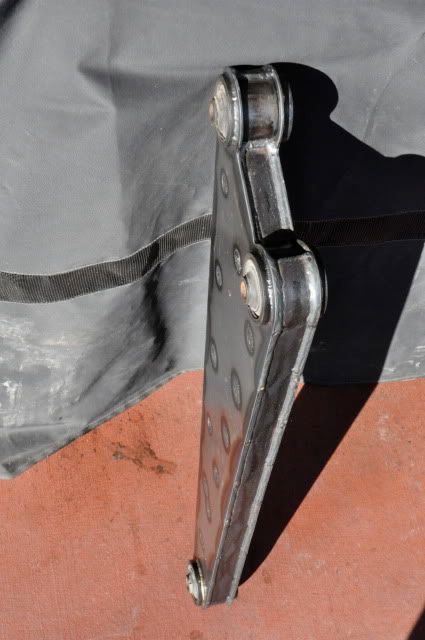

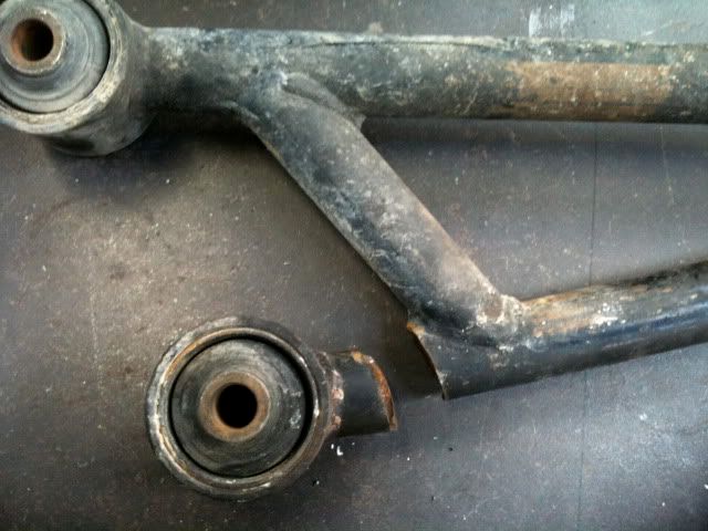

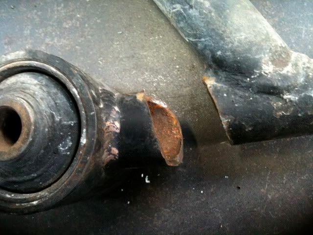

Post by petefj40 »
Murphy's Law isn't it.
Ya start talking about the track bar, and then what happens? :roll:
Getting it strengthened today.
petefj40
Ms Daisy
Posts: 4218
Location: The Mainland
Post by petefj40 »
If this track bar breaks, I'll eat my hat. :shock:
Engineer
Posts: 550
Joined: Wed Mar 29, 2006 12:00 pm
Location: Invercargill
Post by Engineer »
christ! :lol:
LN130 Surf: Coiled SAS, 35" BFG M/T's, Lifted, Rear Lockright, Snorkel, CB, On-board air
Soon to be 3.8 commy powered, front ARB Air Locker, custom bar work, winch...
petefj40
Ms Daisy
Posts: 4218
Post by petefj40 »

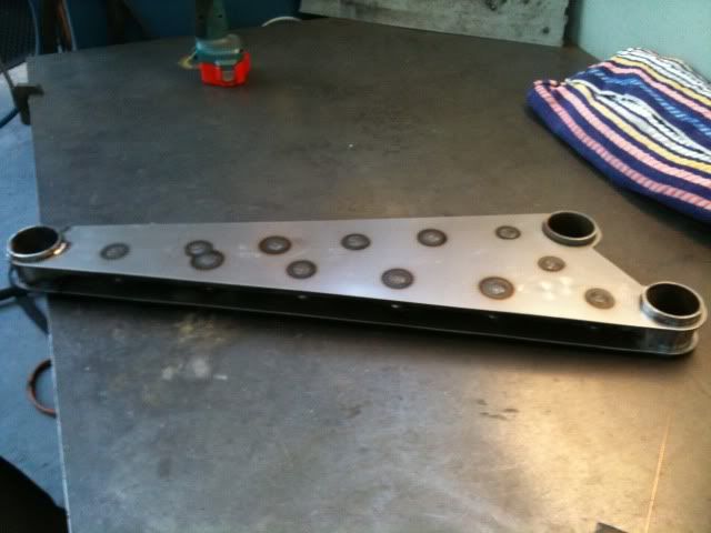

Engineer wrote:christ! :lol:
Just got the track bar back.
Overkill but like I said. It AIN'T gunna break ever again! :twisted:
Cost. Yes I know I could of had it done cheaper.
But I like HRN's work and attention to detail as well as his support after the work is done.
Labour 5hrs @ $65 = $325
Material $85 in steel.
GST $51
Total = $460
I'm still stoked at the end result. :mrgreen:

niblik wrote:source an adjustable one? why? that'll just change other factors like anti squat and pinion angle..
the 4 link will be thru the middle of your tank, yes? :? :shock: just mod the tank.. its only nippin the seam on the back of tank, yeah?
Yeah If i used all 4 links it wouldn't work but my theory was that if i got rid of stock control arms and used only 2 of the links from off the diff to the chassis then it would be a better setup? and still be strong enough to pass cert? fingers crossed. Don't really want to be hacking away or bashing my tank to fit if i can help it, seen ruptured tank of a track before something i want to ovoid weakening
Smurf
Posts: 2868
Post by Smurf »
Do you rear wheels stick outside the body? If so, do they stick out the same amount each side?
Hiluxaholic
Posts: 25
Joined: Sat Aug 22, 2009 8:08 pm
Post by Hiluxaholic »
Smurf wrote:Do you rear wheels stick outside the body? If so, do they stick out the same amount each side?
Yea they do stick out, drivers side is about 10mm wider, so looking at correcting it with adjusty panhard.
