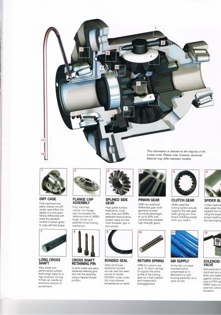

if there is no air pressue thru the line it should dis-engage..... have you tried pulling the air-line at the solenoid and jacking the back up and turning one wheel? maybe the clutch gear is jammed?

Yup, tried disconnecting the line at both ends, disconnected breather. Still stuck. Tried turning one wheel, still stuck. What do you mean the clutch gear? And how is it fixed?

its no 5 in this drawing inside the locker

Oakey doke, took the diff apart, seems that the plastic engagement piston was chipped and wouldn't come out quite as far as it should be when the lockers disengaged. So have a new piston now, hopefully all back together tonight.
