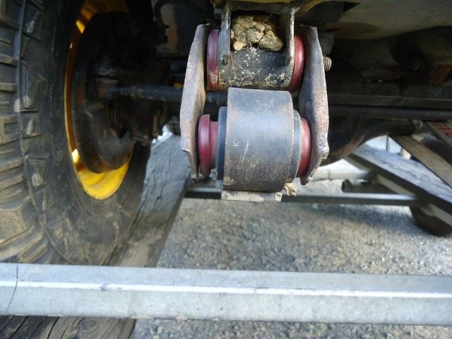

how did the rover t case mounts work, have almost as many also
have they lasted ??
DieselBoy
Posts: 4568
Re: WEAPON
Post by DieselBoy »
Yep, they have done the trick.
Considering they are engine mounts, surviving as a T.Case mount in a little Zook is not a big ask for them!!!!
Best mount available for the job IMO :D :D

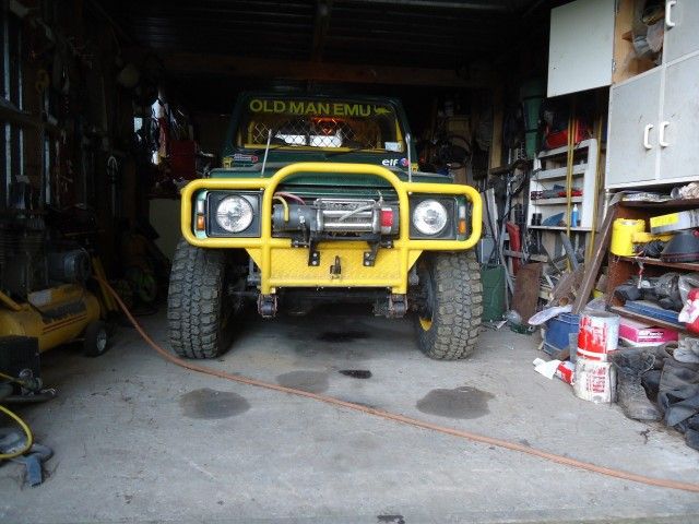

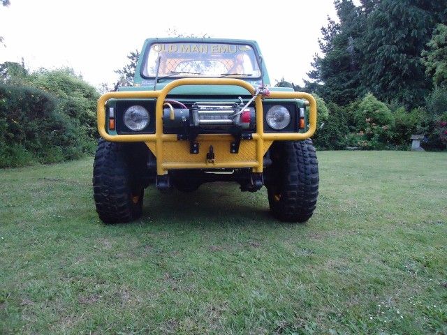

The Weapon got dragged out of the shed the other weekend for the first time in 8 months or more.
After unsticking the accelerator cable and putting some air in the tires it was all go :D :D

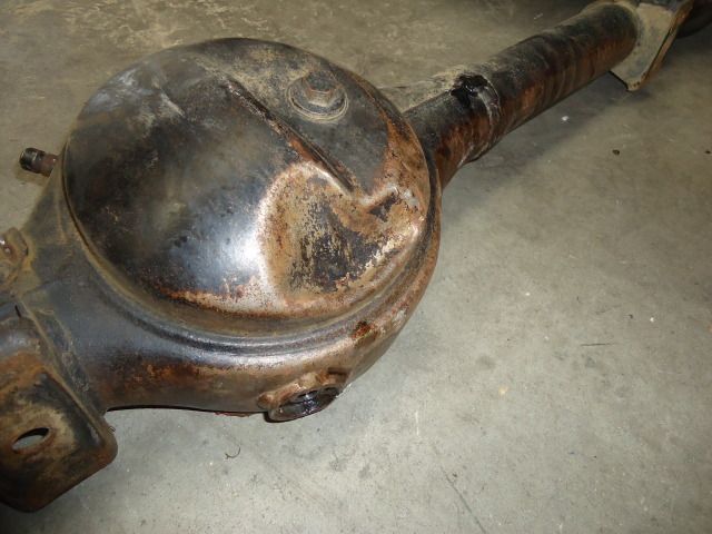

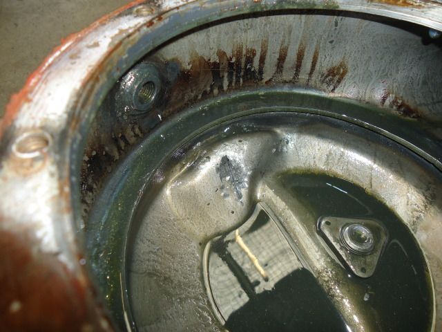

Back in the shed the damaged looked worse :lol: :lol:

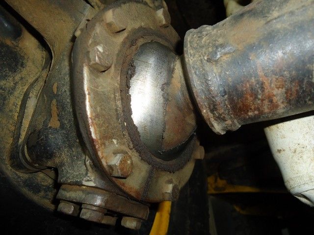

Possibly not the housing, maybe a king pin has snapped. Looking at how the wear mark on the swivel housing doesn't line up with the seals anymore, it may well be :lol: :lol:
Also the nut on the shackle was working its way loose :shock: :shock: :shock:
Not to worry though, the housing needs replacing because of this damage from the Rotorua W.C.

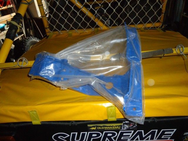

And it would be a good opportunity to fit this:

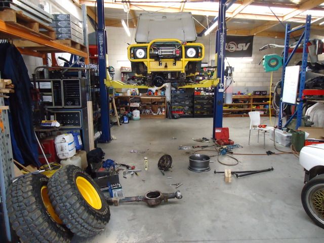

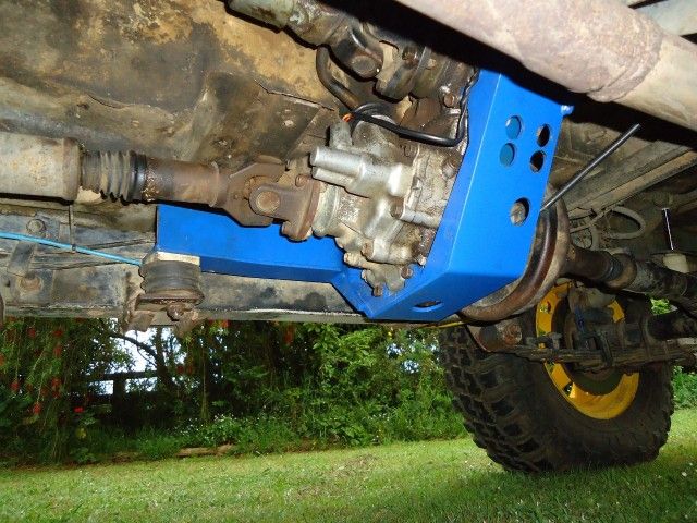

I managed to sneak the Weapon in to the work shop for the day on Saturday.
I had a couple of mod's in the pipe line a year ago so I could drive it a bit harder, but that was before I realised I wasn't as into the type of competitive driving I was doing as I thought, so it all got shelved for a while.
After bending the front housing the other weekend doing mad crazy skids at an off road racing event, and going co-driver at the Nationals for a round reminded me what I used to enjoy about competition, and about the truck.
You can enter it into something and have a blast, even if you finish last, it always finishes, and you can't help but grin when its on the rev limiter in 3rd and only just under control :lol: :lol: :lol: :lol: :lol:

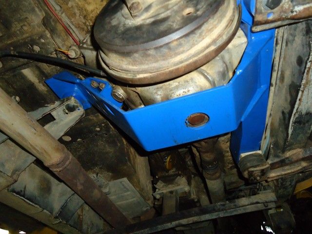

So into the work shop it went, transfercase cradle, new pitman arm, new dif housing, new wheel bearings, new front diff gaurd, new drag link, new tie road and tie rod ends and new Transfercase bush's.
Mission owwwwwwwwn.

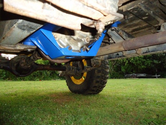

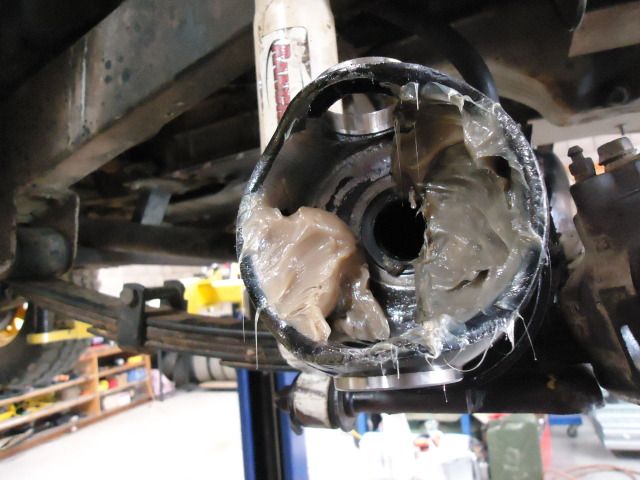

I have had the Calmini transfer case cradle for a year or so and never fitted it. I was always nursing the transfercase, getting of the gas up hills as soon as I got any sort of bounce happening. I was still tearing mounts and twisting stuff. So this is now under it

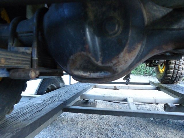

The front diff housing was bent in two different directions. it was tweaked back due to the impact that caused this damage on a night stage at the RWC:
Nice little line from the crown wheel rubbing:

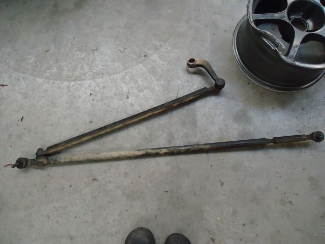

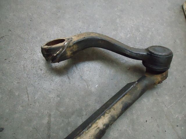

I also smashed the the pitman arm off and the dodgy cut and weld steering :lol:

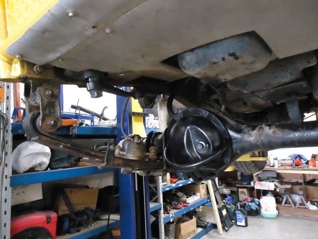

Blazed the diff guard on, and wound the new pitman arm into place.
The pitman arm is a special one-off. I took a standard Cressida pitman arm and had the ball joint pressed out of it and a taper pressed in. It now fits the standard unmodified SJ413 steering linkages. Hope I don't bend it!!!!
I didn't get any good pic's, but one of the big reasons I was puting off fitting a new housing was because of the die grinding work that had to be done on the inside of swivel housings to fit the CV's with the spidertraks rings.
You can kind of see some of it in this pic:

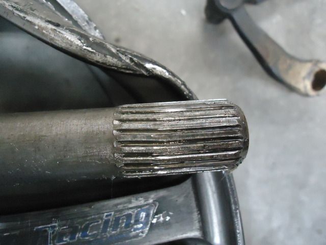

Also discovered a twisted spline on the short side axle. Bet it breaks this weekend :lol: :lol: :lol:
Anyway, I was at the work shop from 9am Saturday and got home at 2:30am Sunday. Mission complete :twisted: :twisted: :twisted:

The result is the front wheels are now straight again 8) 8)
And the T.Case might stay where its supposed to. 120hp and Rockhopper gear set make it work hard!!!!!
Got some vibes to sort out, I might need to do some more alignment work on the short jack shaft between the gear box and T.Case, but other than that, it's all good.
