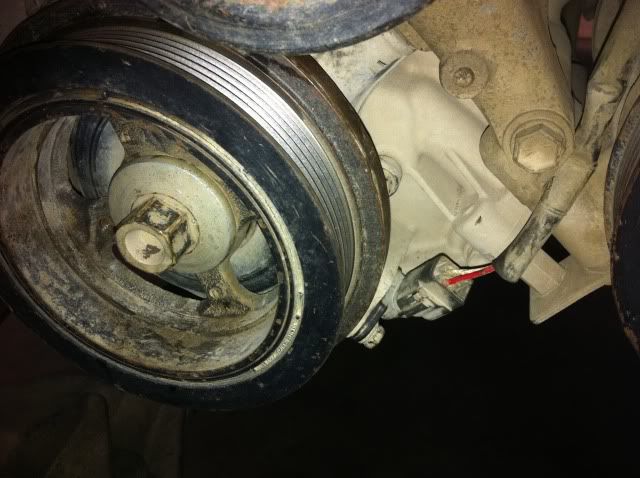

As most know. On that last event I had water issues getting into crank angle sensor and dizzies. So I've brought a setup sortting the dizzys out off Ricky Hammond. He had it on his lexus V8 that kept the dizzy pretty much water proof using a breather from the air intake manifold .
. And recommended I put a window washer cleaner pointed at on the crank pulley. Keeping it clean.
As well as a speedy sleeve mounted on the rotor with a matching seal on the dizzy housing. The bottom crank sensor will be sealed but have a drain..
kaney's thinking. How I hold myself in one piece, looking at this bundle of high adrenaline? I can't contain myself! :shock: I'm off to the John!" :oops:
And the Rotors with the speedy's fitted after the rotors were spun down on the lath.
Now just the crank angle sesor to deal to.

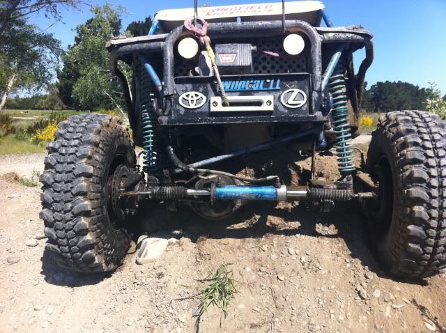

Took the thing out by myself this avo.
Managed to get it stuck. Going to slow over a bit of dirt. :oops:
But i tell you what. Having a good land anchor is peace of mind.
