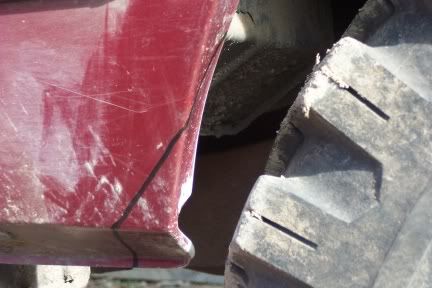

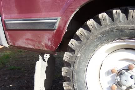

Ok, so i took my Disconator out this week end for the first time ince fitting a" lifted spring, 2" body lift and new 33" tyres. What a nice ride. Didnt get stuck once, droped the tubes to 13 PSI and 2nd gear low ratio is all I needed to get up all obsticals. The new tyres showed me where i didnt cut enought body away by means of some awesome cuts in the new tyres.............
Now the question, where the wheel pulled the body outwards around the back door, do you bend it back and and then a bit further? Or does one have to cut some away but keep enough for the rear door seal to seal against?

I was referring o the door issue, but later I realised that you werre probably talking about the passenger doors and alterations to the C pillars, not the back door. I was trying to imagine how one would need to make changes to the rear of the vehicle to ease tyre problems.
To my way of thinking there are two things you need to think about. The doors seal against the front edge of the rear mudguard so if you cut that out you wont be able to seal the doors and if you weaken it the same applies. So if you need to cut out the edge then you will also have to strengthen the part you've weakened, perhaps with bar or something.
Second, if you go cutting out that part and weaken the structure, you'll probably make a WOF void and not get a new one without certification.

Sounds like you need the "Camel Cut" just google that and you will find plenty of info/write ups

The camel cut.....

not nearly enough cutting for my 33's. i need to cut back tot he start of the rubber mould.........have grinder will grind.............
Will lookup Camel Toe and see whats to be done. Thanks!

Look at extending your bumpstops, if you don't want to cut into the body, I'll post a pic later today of how much I took off my doors.Gofer wrote:Now the question, where the wheel pulled the body outwards around the back door, do you bend it back and and then a bit further? Or does one have to cut some away but keep enough for the rear door seal to seal against?

Oh please do. Im gonna make a start this week end so that would awesome. The bump stop idea might also be the go and will measure them up tomorrow too. Thanks a ton.

Mine were ok with Camel cut and 32" until I put in 30mm wheel spacers, then a bit more cutting required both back and front. The plates that the mudflaps used to hang from I had to hammer a bit and push them further back, probably still need a bit more beating really.
Already had a OME 2" Lift.
BFG's 235/85/16 on standard steel disco rims no extra offset.
Will consider severe chopping like this at some stage as i have a set of flares to go on at some stage.
http://www.discoweb.org/ecrflares/index.htm
http://www.discoweb.org <- A couple more cut instructions here also.
