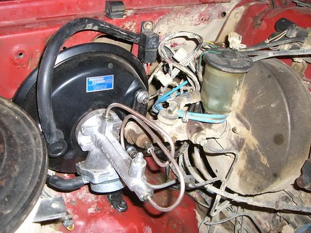

Interesting..
Pictures?
Re: 70 series brake upgrades?????
kbushnz wrote:Interesting..
Pictures?
My master cylinder has outputs for front and rear brakes so my extra booster is only plumbed into the front brake circuit, makes a big difference to underbraked 70 series :mrgreen:

Is that a vh44 nissan booser/master cylinder? If so whered you get it from an how much? :mrgreen: THink ill need the same to get mine certed :roll:

pagar, buy the look of Sadams photo he is running the extra booster in tandem with the original brake set up. My brakes where nothing startling before fitting Bendix 4WD disk pads they made a huge difference but don't last very long.

Its mounted directly infront of the toyota master on the front guard. Having the extra pressure to the front will act like a proportioning valve which you will probably need to get brake bias right anyway

SMOKEY wrote:pagar, buy the look of Sadams photo he is running the extra booster in tandem with the original brake set up.
Yep what Fitzy said, when Howie stuck mine in he said it needs to be as close to the master cylinder as you can get it and keep the brake line connecting them as short as possible, mines in a 70 series and it fits snug and out of the way mounted on the inner guard beside the master cylinder. My truckss only running the factory proportoning valve at the back and its broken anyway so I dont know what its set to but the brakes work fine on mine even though its never been through cert at this stage, Rob did his 70 before me with the same combo of extra booster and subaru callipers on the rear and his went straight through certification. The extra booster mostly gives you that big hit and increased clamping on the front callipers when you jump on the brake pedal and it makes it seem more like tryng to stop a late model car than a heavy old truck
Fakey go down and see Andrew at BNT and quote VH44, I think they are some generic part they used to use on old pommy cars or something like that, cant remember how much but somewhere around $300-350 rings a bell?
