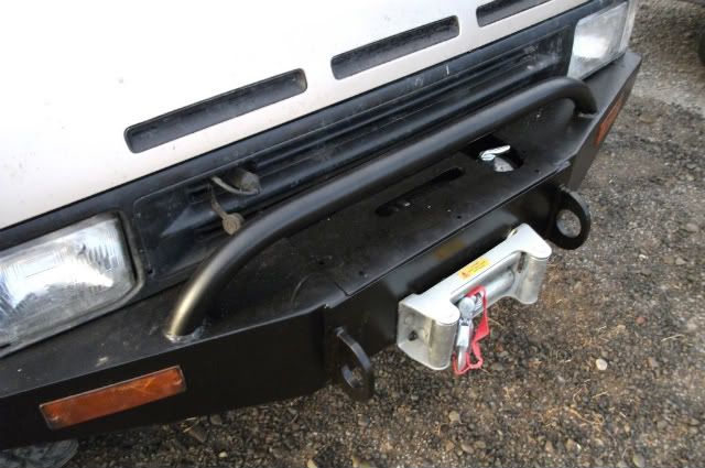

hi, is there someone on here who i can e mail some pictures of how im mounting my winch and give me an oppinion?? i would not have a clue how to post pix on here, im useing the two origanal tow eyes in the front, ill give up loading a pic a go,
thanks, nick,

ok so after a second attempt i come up with this, thanks for the e mail i did get with some suggestions, it helped me make up my mind, hope this helps someone else with a terrano or similer, ill post pix also when its finished,
http://www.offroadexpress.co.nz/builds/ ... rno-bumper

Mate nice work, great fab skills!
Love when someone thinks outside the square..

thanks, so far its cost me $70, the rest is just bits from the engineers off cut bin, once its fully welded and painted it should look good, till the first outing anyway, oh and i also searched for hours but no one ever shows how they are mounted, have more pix of mounting if anyone is interested,
all finshed now, cheap to build, solid, happy with it, used winch on the weekend no problems at all,

Nice work, and in keeping with the Kiwi way......sometimes easier to just make your own.
Looks solid too.
