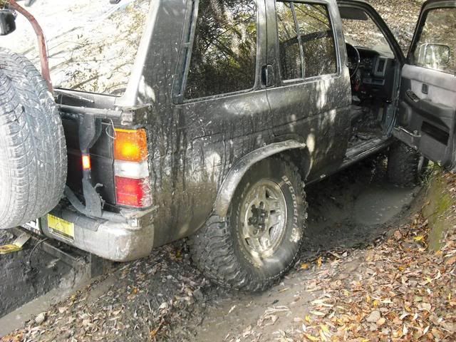

I had 3inch lift and 3inch body and 32x12.5 bfg mt that measured in at 33 and never got gaurd rub
here some pxts
before body lift got bit of gaurd rub ..
heres the gaurd rub
After body lift a heap of room to flex and no rub at all
flexing with body lift
here some pxts
heres the gaurd rub
