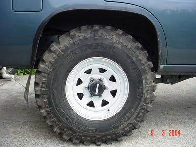

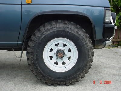

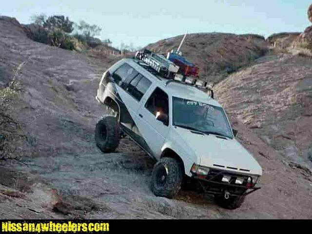

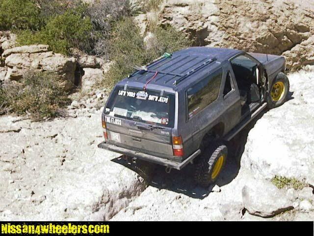

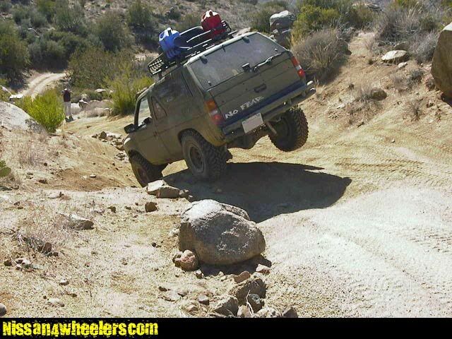

By the way, i was was running 32 x 9.5 Simex's on my Terrano (33.4 x 10.8 when measured from the tread) and all i had was a 2" sus lift. Minimal rubbing, only from the back wheels, not the front.
Front
Rear:

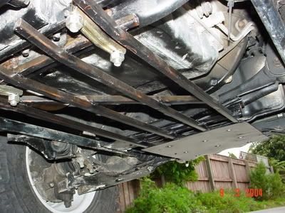

And you may want to think about somthing like this:
It Protected the engine and gear box sump, as a replacement engine sump from the wreckers cost me big $$$$$$$

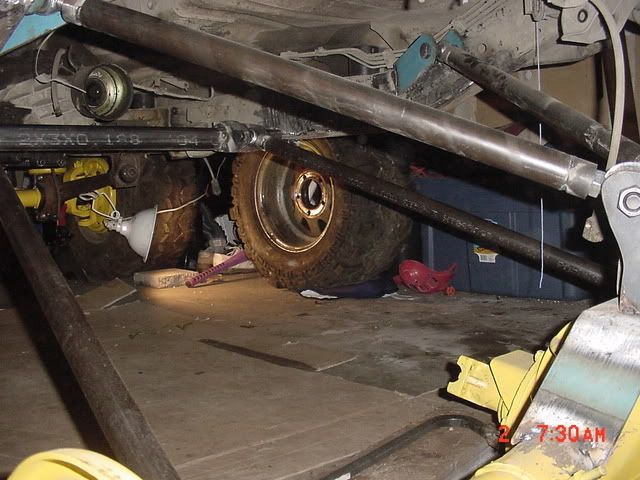

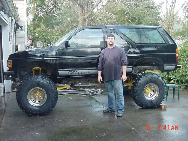

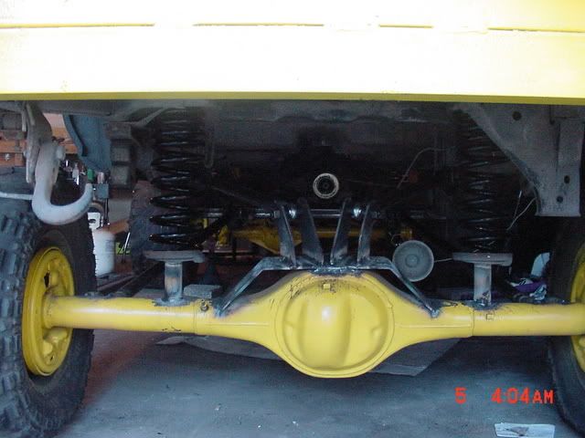

And oh the potential!!!
Front:
spring buckets, located on frame stand offs (this eliminated the necessity to shorten the axles) spring buckets were from a 76 ford F150. Radius arm mounts, Custom. I used 5 deg bushing for the radius arms. Then i had to locate the radius arm mounts at the proper angel to keep my castor angle correct. Springs are 5.5" wildhorse rock crawler series. These are normally for Early bronco.
HPD44 axle
Rear,
Unless you have are very good in math, know somebody who is a geometry wize, who can fabricate anything necessary, and you have the formula to calculate it all.... Don't even try to do a triangulated 4 link. its not easy! (My job is custom fabrication of Heavy and specialty equipment) rear spring are 3.5" wild horse rock crawler series. They are located on 4 in stand offs from the axle.
Ford 9" axle
I have a 3 inch body lift installed. before i started I was running 30" tires, and had 13.5 inches of frame clearance. I know have nearly 24.5"
I also have a custom Hand throttle, so i don't have to do the 2 foot 3 peddle shuffle.
I remind you ITS NOT DONE!!!
