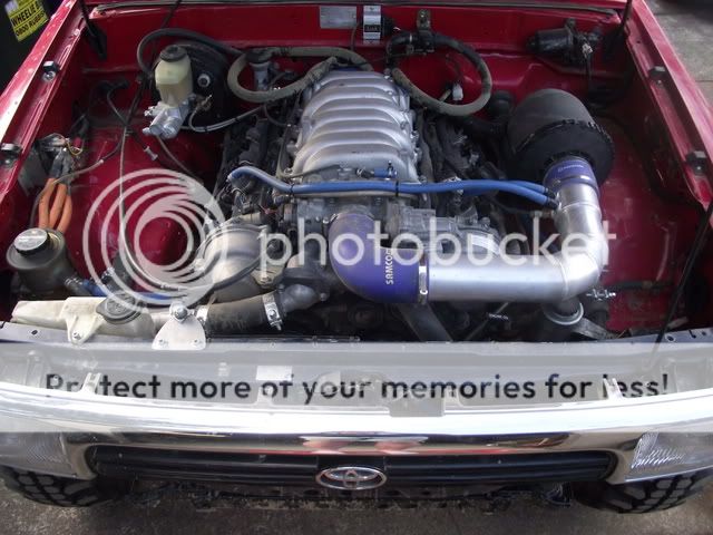

heres one .
Re: VVTI 1UZ
fark thats tidy, yours?
cheers Daniel
cheers Daniel
Re: VVTI 1UZ
yea , only those shiney days are long gone .
Re: VVTI 1UZ
oh your ones the red one that was one of recovery trucks at Manukau winch challenge last year? If so it's a freakin awesome truck!! love it
