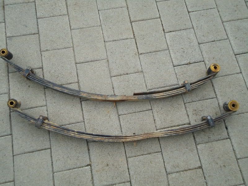

An are there leaves missing from that bent pack? looks like there are 2 or 3 missing?

Drurban wrote:Here are my OME springs only 6 months used and had only done a couple of trips.
Theres some serious spring warp going on there Drurban, skinny packs like that need an anti
tramp bar to stop them warping and twisting up like that, did they come like that or have they
had leaves taken out coz the centre bolts are pretty long looking?
I've typically had heavy spring packs in my cruisers so the springs dont warp and twist up
(or flex much :| ) but something has to give and my 350 flatdeck cruiser ended up crushing
the spring perches as the next weak point to transfer all the twisting to
I've got new spring perches with the ends capped off to strenghten them now

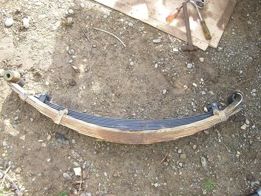

sibainmud wrote:1st trip out :(
Not mine but I was there when it went ping.
No apparent reason.
there must be some reason to cause the spring to break, you can see its been bent so there must have been some sort of impact to bend it, do you know if the shackle had inverted? :?:
I've probably been lucky in my 25 years of hammering leafsprung trucks although I've bent a few springs I've only ever managed to break one and that was a front spring that was already bent and was loaded up onto the shackle stop and I bounced off a track and smashed hard into a drain under heavy rightfoot jandel and blew the eye out the back of the spring (it was Beer_Tara's fault :roll: :x :lol: ), other than that all my leafsprings have taken years of punishment without any failures, the place my spring had bent is pretty much the same as the pic above the only difference is the break point where mine unloaded
