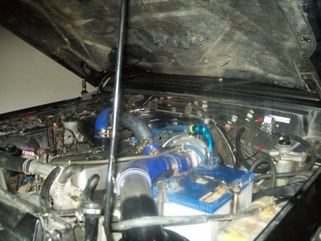

Re: my turbo fittment
just a pic of done job engine bay didn't put one up before
