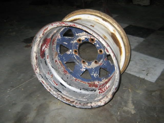

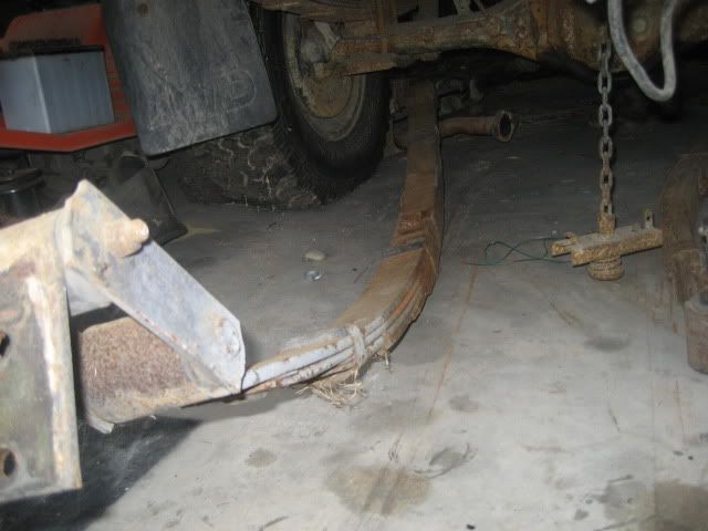

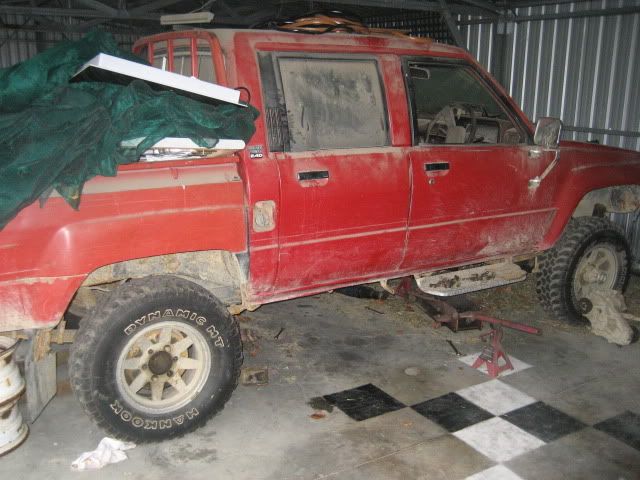

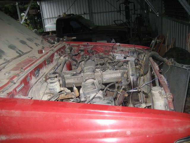

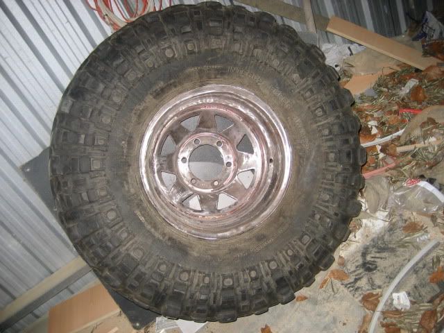

Hey guys as promised attched are some pics, i realised that i had never taken any pictures of it in the 4 years we have owned it. haha. well the pics speak for them selfs and as said before we have a long way to go. cheers.

Hey was the hilux originaly petrol or diesel? did the engine mounts line up?
haynzy
Posts: 1144
Location: Palmy North
Re: 85 Doublecab Hilux Crawler Build
Post by haynzy »
hilux81 wrote:Hey was the hilux originaly petrol or diesel? did the engine mounts line up?
with a diesel lux the mounts all line up for 5m using 5m engine and diesel chassis mounts, also the fuel lines, and clutch slave cylinder on the correct side also
hilux81
Posts: 49
Joined: Thu Aug 27, 2009 7:48 pm
Location: dunedin
Post by hilux81 »
Cheers haynzy just putting a 7mge into a petrol hilux mounts dont line up not a biggy to fix tho. Will be running bigger fuel lines etc.
