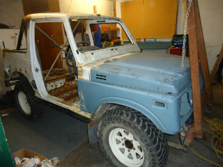

Hey i recently brought this sj & ALOT of parts for $500 so im a happy guy!!
Its an un-reg hack about for me that im going to A-frame around.
Its got a 2inch suspension and 2 inch body lift running on 30x10.5 inch tyres
with a rough running 1300 :lol: been roughly cut down to a ute with a rough rollcage on it 8)
Its called project Bogie after my dog which got put down on the day i started working on it :evil:

There it is all stripped out ready to go for its reconstruction. I have never done anything like this before so im real excited to get amongst it and get some experiance fixing a vehicle up :D
The plan is to get rid of the rust yeap theres a bit of it
put a ply roof and back onto it with a rear sliding window with a frp top both easily removed for the summer trips =)
A snorkel
bull bars front rear and possibly on the sides ( steel prices dependant)
spotties galore ( ohk only 4) :roll: haha
a boat fuel tank on the back deck
have a set of full doors and a set of half high doors for the bunny hunting trips
a perspex windscreen that can fold down ( does anyone know where to get a sheet for cheap?)
a paint job ( cant decide what color yet)
get the carby running sweet
Then possibly
A lockrite in the rear
a spring over axle lift
bigger tyres
rock lights
and who knows what else when i get more obsessd :roll:
As im totally new to this any tips/ ideas from all of you zooksperts would be awesome!!!!!!!!!

Well i had a decent crak at it this weekend.
Completly stripped the carby down was surprised to find alot of rust on the walls beside the butterflys that was restricting the movment of them so spent alot of time getting that off with a small file and kerosene the whole carby was filthy so alot are parts are having a soak for a clean tomorrow night.
Also got into a bit of body wrk done too.
We sanded off alot of surface rust and painted over with kill rust so hopefulli thatll help stop that.
I also tried out an awesome idea i had. Seeing stel prices are soo expensive i wanted to find a cheap way to fix the corners and while i was doing the dishes the other night whammy thought of the most ghetto style way on the planet!! :lol:
Use a baked bean tin cut down into a panel then rivet it on and bog over top :lol:
Not for those boy racers but seeing that the corners will prob get redented anyway it shuld be sweet and it actually came up alright !!!! 8)
So alot of painting and bogging and cleaning it was a good sat!!
Now iv gotta try :oops: and put a carb back together this week and start sanding the bog.
