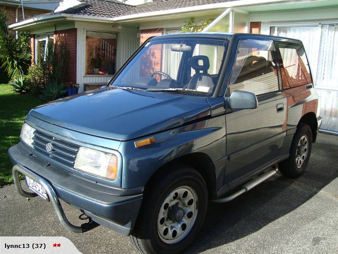

I've always wanted to have my own 4wd and finally i bought a 1991 3 door suzuki eskudo (automatic, because i'm a girl so i'm allowed to:) ). (yay!) But here comes my problem. I also dreamed about going off road but unfortunately I don't have enough knowledge or experience to make up my mind about the modifications i have to make. The only thing i know is that at the moment i can't afford lift kits, but still i want to be capable of going off road. What would you recommend?
Really looking forward to learning something from your experience and maybe later on after the modifications meeting you somewhere in bushes (if you ever see an escudo badly stuck in mud, that would probably be me:)
