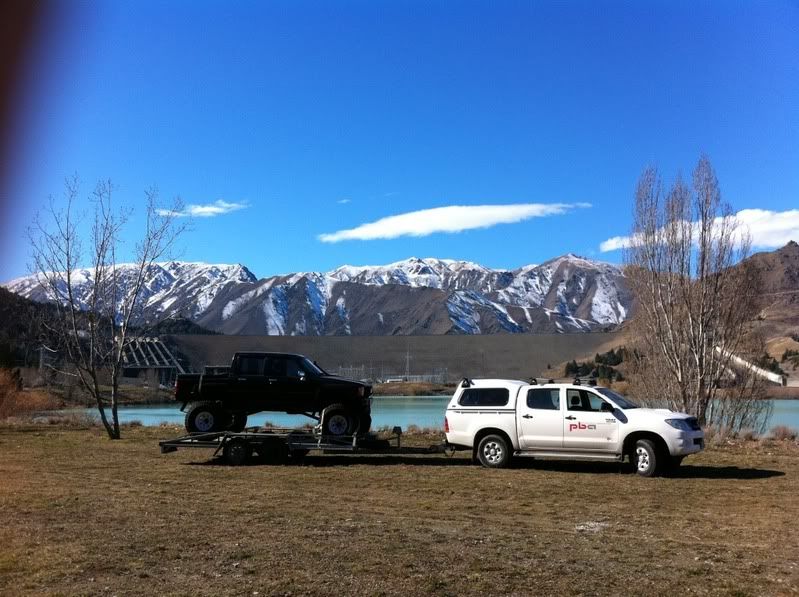

New location for furious modifying...
Tow rig from Chch to Otematata.

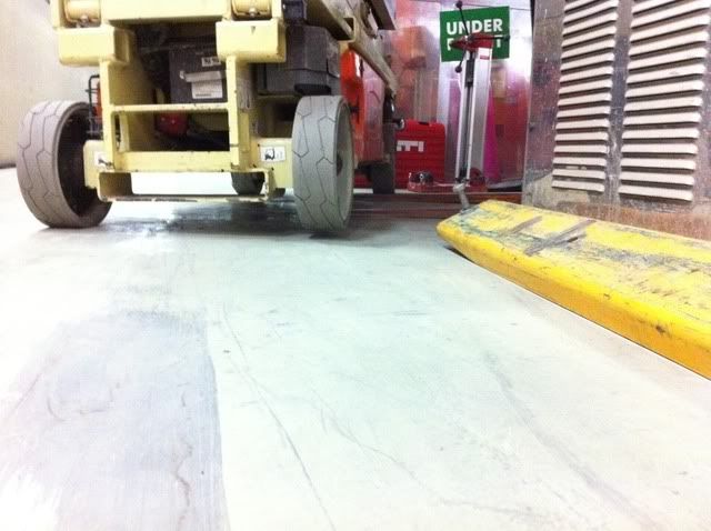

Tried to Flex the Scissor Lift, needs a bit of work.
