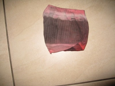

Due to the intercooler I need to run some aftermarket air filter and K&N fits the space just fine.
After thinking about comments here though I went to the local pool shop and got a filter sock for over the K&N. 1,000 km later here is the result.
Not sure if it actually saved anything from getting into the engine, but I figure it can't do any harm.
Re: Terrano K&N air filter?
The Stranger wrote:I went to the local pool shop and got a filter sock for over the K&N. 1,000 km later here is the result.
dunno what shape and size filter your running but K&N have all sorts of washable prefilters than you run filter oil in :mrgreen:
