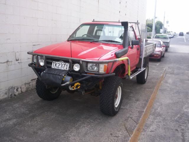

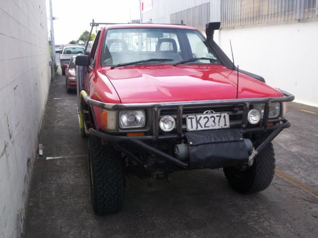

got asked to do some bar work for a club member when was busy with turbo and work, said yes but time didn't allow, then stateside , he did a snecky phoned the boss now doing it, hey lest I'm being paid by the hour
added to the sides to get them out farther
and wishs atop bar on his winch bar and removable side bars
8 hours so far

Looks good there fella. Well done :wink:
I do have a wee question :roll: Is the gap between the sliders and the sill big enough for a foot to go through? Could be nasty if so :wink:

yeh nice tidy work there coxsyi have a question to :roll: what sort of bender are you sing?the jam it between 2 points pipe bender or a proper tube bender?if you dont mind me asking ofcourse
Re: toyota bar work
air power hydrolic bender, today the job goes on, maybe finish friday, have to drop winch bar to get the welds,
yes you could be right there tom, but that bit wasn't done by me :D

mhm very tidy by the looks of photos,seriously considering purchasing a pro bender 105 manual bender but still not sure if i can justify the 2300 for everything including notcher,keep up the good work mate :D
Re: toyota bar work
completed it a 3.45pm today, also notched the orginal bar so he could get the winch to freespool :roll:

hey whats with the swimming pool hand rails on the back coxsy I've never seen anything like those before?

With the sliders is it ok to weld to chassis or does that require a cert.
Welded requires cert

Sorry but I don't like them.
The sliders are too far from the body.
The angle of the pipe along the side by the guard looks wrong.
They look like they would get hooked on anything they touch.
But that's just my opinion :roll:
As you were :wink:
Re: toyota bar work
most properly right, first time for bush bars sliders took two times to get right, but nobody want to pay for the work so you get what you can :D

Something else worth noting on those side bars is that there is no actual sill protection. Now if you like having your truck looking like a massive, beaten up piece of shit, that is fine. But if you are fitting barwork to actullay protect the skin, then you have to think about what takes the biggest hiding.
they caused me a headache, he wanted something to stop the edge to the deck digging in to banks when it leans over, as work ute need to be removable,best i could come up with, staff of 9,no help from anyone :roll:

mylux wrote:Sorry but I don't like them.
yeah there way out there but you can see there like that to stay in line with the width of the deck to try at stop it from getting hooked up :mrgreen:
Yea I can sorta see the logic behind them and I don't like to knock others work but perhaps if there was another bar put through the gap between the body and the outside they may look a bit better. :?:
Re: toyota bar work
yes can see that, but these are welded to chassis which i don't like, straight off plus the ends are unsupported, can, will rip the chassis,at sometime
