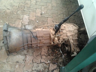

like any young farther on a apprentice wage i was on the hunt for cheap parts
looking threw trade me i found a cheap gearbox for one off my diesel terranos
bought it. put it in and bearing noise in the higher gears, drained the oil and out poped a piece of metal
at first i thought it was part off a bearing.
after half the day off thinking what it could be i figured id seen it from 3/4 syncromesh/gear unit
long story short i now have two terranos with gearboxes that need rebuilding again
i will post some pics and info over time on how i get along with the rebuilds
also if anyone has a diagram off the terrano gearboxes (manual) that would be very helpful and even a transfer case diagram.
im going off a ca18 diagram which is mostly the same

You will probably find it is a chunk that has broken off the counter shaft after the key way have been ripped to shit by the backlash.
I've done this to my box twice now, i've had enough so I welded it on this time. Not exactly "precision engineering" but will be stronger than the two keys from stock albeit non serviceable.
Also check to make sure your spigot bush is in good nick (one in the flywheel) as if that is buggered it will put nasty forces on the front bearing and needle roller bearing between the main shaft.

what ever you do dont put the standard bearing back in it. Take the bearing to a bearing shop and get the needle roller equivalants.
My old box was done once by a "reputable" company on Pamure Auckland, they did half the bearings with standard ones and left the rest, box shat itself less than 18mths later. Had a semi retired gearbox guru rebuild it second time around and he did it with roller bearings and it was a better box than it had ever been.
Guy that did it said he had seen plenty of terrano boxes fail under 100K on stnadard bearing, then fail agin within 100k if done with standard bearings.
I put 180k on mine after the second rebuild and it was still smooth, quiet and easy shifting, and it is still running around 4 years on from when I sold it, must be gettin on for 1/2 million ks on truck and 300 on box since last rebuild.

emailed a few bearing and gearbox companies and they say you cant use needle roller bearings
"You can use cylinfdrical roller bearings, but then
you have no location on your shafts and end up with 5th gear problems" and that's one email i have had back
best bearing kit price so far $185 being a TM series bearing. meant to be a heavy duty bearing. will still need to buy lock nuts on top off that and front gasket and seals
onto another part off a story
bought a fully rebuilt gearbox from one off the garages down here who rebuilds a few off these, the guy said to use 2l 80w90 and 2l normal mineral engine oil 15w40.
said not many people know about doing this and it helps keep the gears and especially the syncro units clean and better shifting
has anyone tried this before?

Re: d21 gearbox rebuild no2
The d21 td27 has the fs5w71c
the terrano II has the FS5R30A
This fits in and you will not break it with the td27
You just have to find one. Here is the one going into my terrano before the weak one breaks. I will sell the orginal
