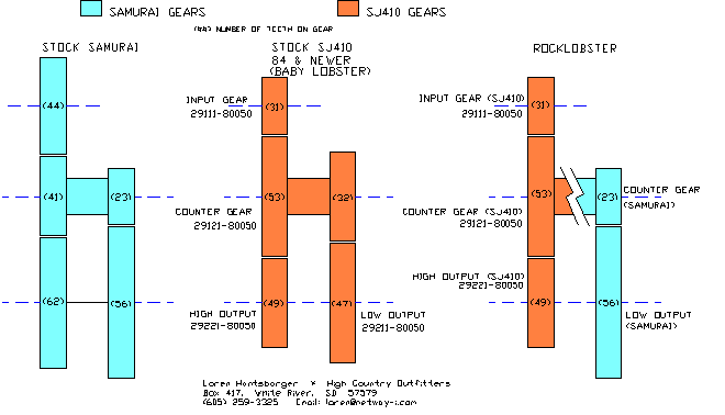

This may help explain what is going on .
Note the 413/samurai ratios and the 410 ratios , the 410 ratio's are the 1984 410 ratio's . The earlier t/cases are very similar in final ratio but use different gears to get them and can't be made into a 4.16 case . A rocklobster is a 4.16 t/case ( as you guessed this refers to the ratio in low range ) .
Short answer a 4.16 t/case would be a good option but it does not correct a speedo error from larger tires ( minor issue )
Std 413 high is 1.409 = (41/44) x (62/41)
Std 410 high is 1.58 = (53/31) x (49/53)
12% change (1.58-1.409)/1.409
Std 413 low (41/440x(56/23) = 2.26
Std 410 low (53/31)x(47/32) = 2.509
(2.509-2.26)/2.26 = 11% change
4.16 t/case will have 410 low gears so a 12% reduction in high and 4.16 gears in low so an 83% reduction in low . And yes I was killing time :)
Chris

That diagram is so well done, definitely cleared things up for me. Its awesome to know how the actual ratios are calculated other than just doing the whole rotate and count thing.
