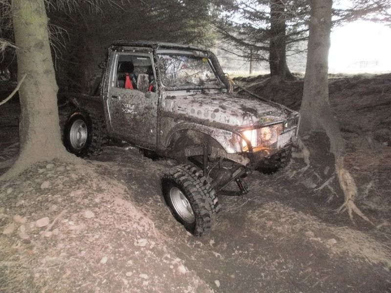

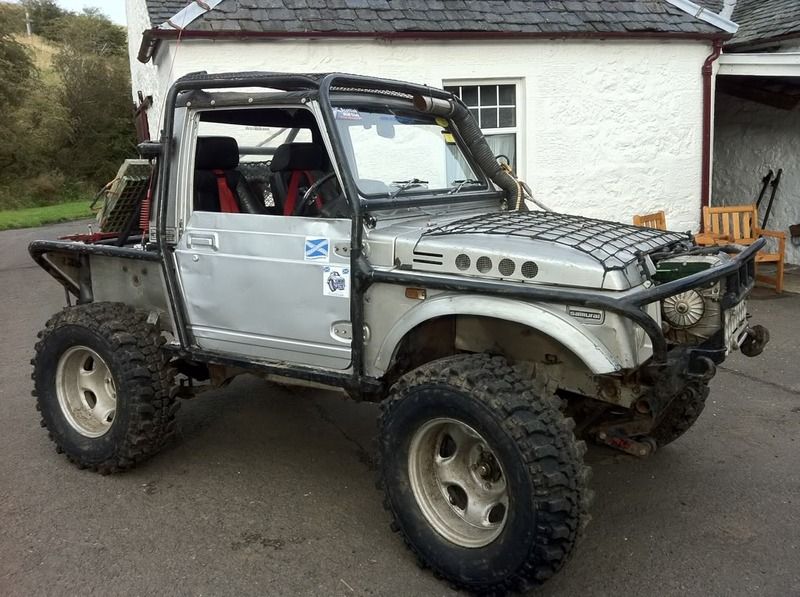

based om 92 samurai
1.6 vitara(escudo?) 16 valve efi
6.49 rock lobster transfer box
rear lock right
Rear disk conersion, disk converted hand brake
3" lift springs, still spring under axle
extended steel brake lines

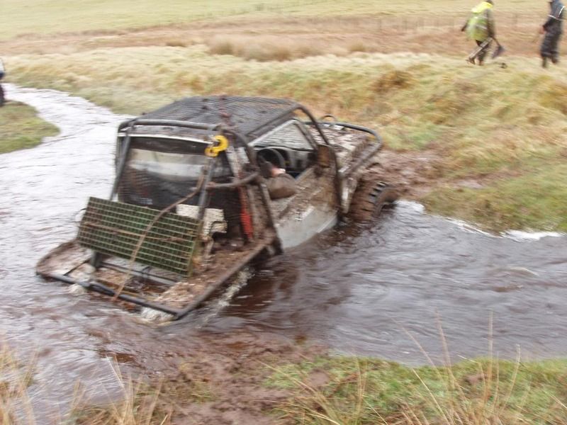

tray backed rear and tubular front wings, cut down summer doors
front gigglepin 8274
rear good winch g10
3x optima batterys, relocated fuel tank from donor vitara.
265/75r16 insa turbo special tracks mounted on modified Grand Vitara steel wheels, cut out and re-welded to increase offset
160a alternator off range rover p38
standard shafts and C.V`s
It was built for winch punch events and play days.
Ive got a set of Land rover axles im thinking of fitting still undecided.
hope you like it
