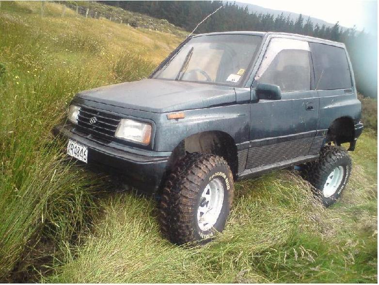

Re: Vitara Escudo front diff (help)
my truck
