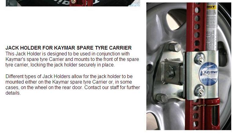

Wanting to buy a holder to fit a spade and hi lift jack to bolt on the back of my trucks spare wheel.
Have a photo below of an Aus website who has a really tidy one for the hi lift jack but really wanting to be able to have a spade as well and perferably my snatch rope too.

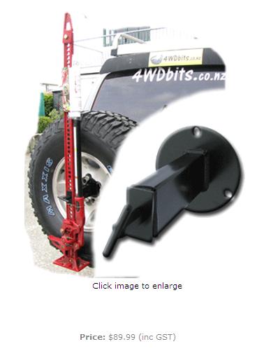

Thanks for that I gave him a call they only do that one I had put in the photo above which only does the Hi-Lift jack and it is very pricy. Found this one at a third of the price but still only a jack holder.
Re: Spare Wheel Holder - Spade + Hi Lift Jack...? WTB
Suitable length of threaded M12 rod through an unused hole on the spare wheel, add a couple of nuts, even weld some finger lugs onto one nut to make it a wing nut if you like so jack can be removed without the need for tools. I then bungee the spade to the jack. Worked fine like that for a few years until the trucked got turned into something a little more "off-road" focused.
