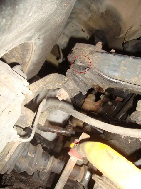

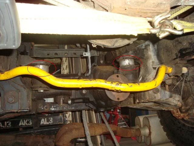

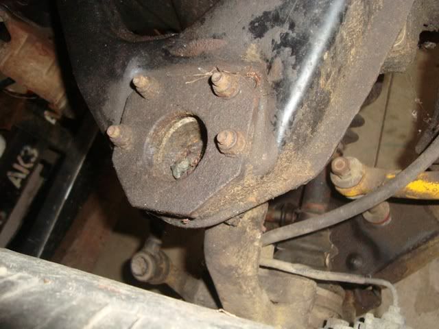

yes its completely fine to do just suspension lift then body lift at a later date.and weather or not the ball joint spacers actually put the alignment parameters out or not I'm not sure as the plate to move holes was only on the left hand side.drivers side adjusted up no worries so i think potentially my truck might have had damage or have been bent in some was.here's the pics anyway
plate welded to top of LHS arms
a arm where you can just see the spacer circled in red
and diff drop blocks,again circled in red

the diff drop blocks are they just steel?how much does it correct the cvs? sorry for the thread jack

The blocks are just steel. i think mine are 60mm dia x 25mm thick.
They bring the axles down a bit, better than not having them. only cost me 15 bucks down at the engineers.
but im going to go to a 1.5 or 2inch drop once i sort the exhaust as it runs under the driveshaft preventing the diff from being dropped any lower. This should bring the axles to almost factory angles
