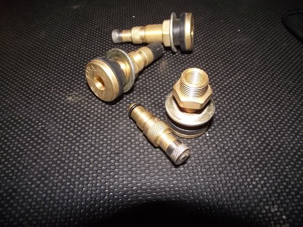

I got a handful of tubeless dump valves last year and threw them in the glovebox and ripped one of my tubes out and stuck one in yesterday when I got yet another puncture :roll:
has anybody been running them and had any problems with them, I run my creepies on 10” beadlocks usually at around 10-12 psi in rutted stuff or go down to 4-5psi if I don’t have to worry about diff heights and haven’t ever had problems knocking inside beads off with the tubes in them

the first one seems to be holding pressure so far, I had to nip the nut up on the valve stem pretty tight to stop air escaping around it, all the welds seem to be holding air ok

I'm running tubeless with those very same valves.
Did a whole day with 8 psi in the fronts and 6 psi in the rears with no problems. That said my front tires are 5" wider than the rims and rears are 8" wider than the rims so have pleantly of pressure pushing out on the inner bead.
Will drop another 2 psi front and rear next trip and see if there are any issues...
