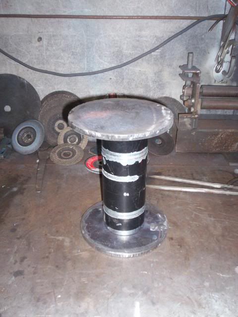

started on my steel winch drum and grapped a front diff housing cheapish
going to add superior plate kit to it , its ordered and on its way
and part one of the drum
10mm plate and 80mm id heavy wall pipe 40mm longer overall

yer but still a ali drum, steel is better for plasma rope
Re: nissan safari steel pto drum+ reinforced front diff
well in small bits, turned up one end flange, decieded on how to do bushing ect then decieded drum centre pipe to large, so will down size, so need new end flange cut, mod drawing for bushes, :roll:

so its weld 25mm, let in go cold, weld another bit. with two earth leads and throw the hand peice from one end of my work bay the other, for a quick weld getting it done
drop boxes welded by certed welder and drum moving along at last
