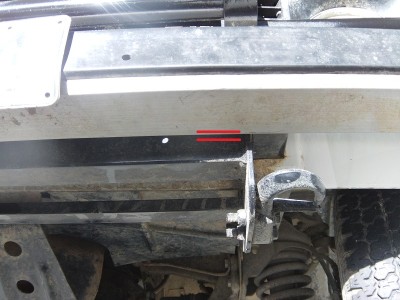

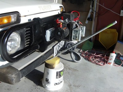

Re: dont hate me cos its a lada

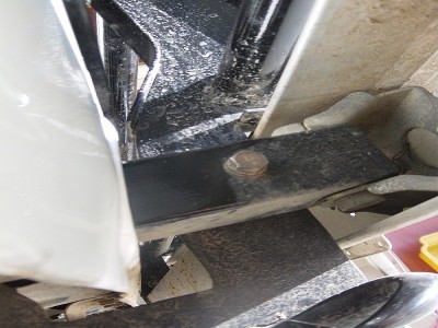

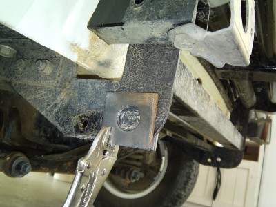

Nivapulledout wrote:
verry true totaly missed that one. clearly underestimated the forces i see.
have a look at theese and let me know what ya think. cheeres mate.

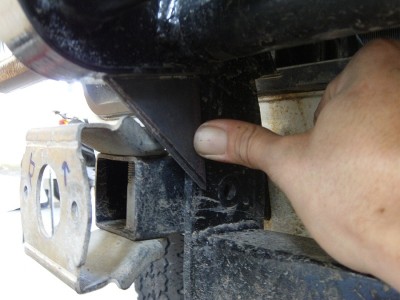

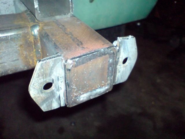

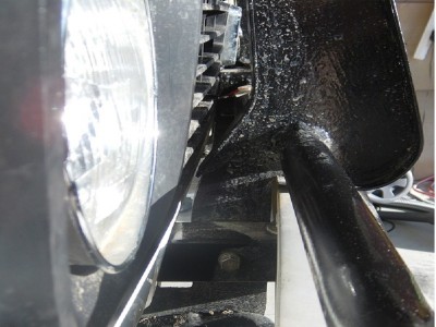

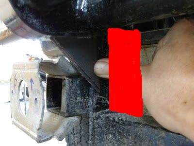

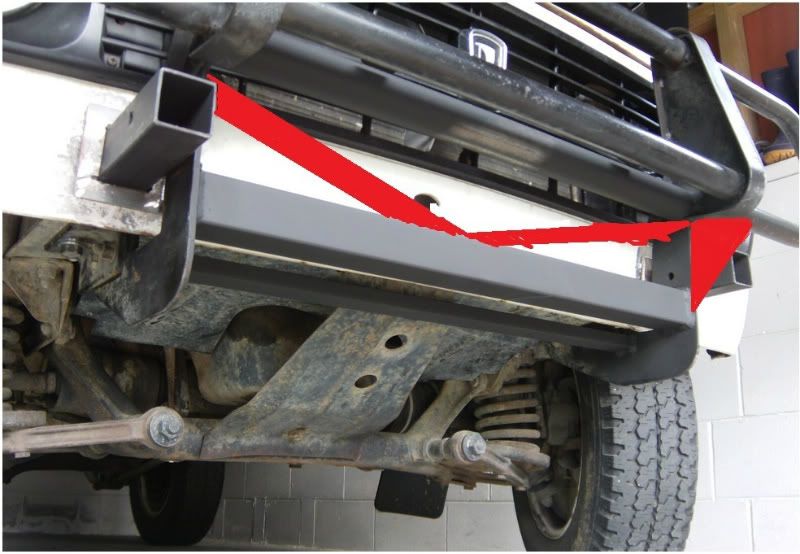

this is looking up.
wouldnt of thought could of broken that +- 200mm of plate but then again didnt think about leverage and twist did I
any ideas on how to work around the bumber bar maby just welding a srtip of steel to the plate.
Input greatly appreciated.
I would make the diagonals out of flat bar something like 75x5 or 100 x 5.
I have had another look and the only way I can see to help brace against the fwd leverage is the triangle gussets, maybe not as big as I drew but that is where the strength needs to be, I would cut them from the flat bar that you use for the diagonals and then just put a grinder cut into the bumper so it slips over them.
Otherwise It looks fantastic all fitted together. Like the look of having the bull bar. I wanted to put one on mine but wanted to keep the weight down as much as I can.
keep up the good work.
Nivapulledout wrote:I would make the diagonals out of flat bar something like 75x5 or 100 x 5.
Thanks for the advise mate
I will definatly be doing the extra suports when I get a chance.
IT'll all be put off for a while though as moving house soon.
first pic triangular gusset is spot on should help alot. I am guessing that is as big as you can go due to clearance to the bumper.
bottom pic I am not sure what that gusset is for?? that existing bottom brace is ok how it is because not much side loading on those more longitudinal load. I would leave them how they are unless there is another reason for them.
I had a closer look at your pics with the bumper on and I can see why you cant do the diagonals without carving up the bumper alot. So the only think I can see that will strenghten those uprights to side loading is welding in a piece of flat bar like so. you can move it back further I just drew it to show you what I mean. see what you think
Hope it helps , keep up the good work.

With those gussets that will be the exact location where I will weld them i.e. with a slight overlap of uprights, reason for this is if I but weld to uprights it will foul the bumper brakets. recon this should be OK?
What I was getting at for the bottom pick is im thinking of getting rid of the tow hooks and welding those plates on each side to beef up steel to 15mm thick, then drill a hole through to use as holes tow points with a bow shackel, reason behind this (my thinking, that may be way off the mark) is with no hooks there is no hooks to break, ie the simpler the better??? whats ya thoughts?

no I would not overlap the gusset, you want it inline with the upright so it will let the stress flow through it. what about modifying your bumper and brackets like mine, would have to weld on a little bit longer 50x50 box but you would end up with clearance for the gusset and stronger bumper brackets. I was always bending the original ones up that is why I did mine like I did.
post pics of everything before you weld and I can double check for you. saves grinding off welds and redoing

Forgot to say that your Idea of shackle/tow holes is a good one. try and move those bracing plates up till they hit the 50x50 box if there is room with the bumper. once again for side loading the closer you can get the shackle holes to the cross member the more sharing of side load will happen.
yea I thought you might say that
I have been thinkin of weather to just cut the bumper bracket a bit so can weld gusset inline with uprights. or to change brackets completly to something like what you have done.
My issue there is, because of the 50x50 Xmember it leaves no room to get access to the two inner most bolts of the bumper to bumper bracket bolts,
will maby look at doing some kind of slide in type mounts.
