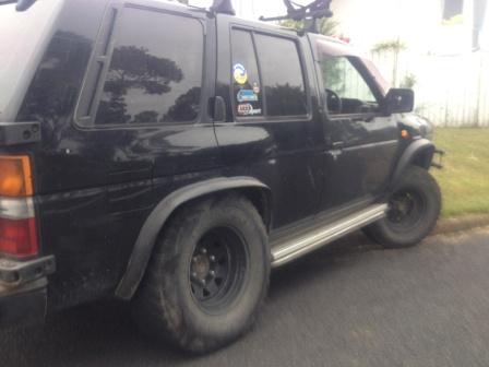

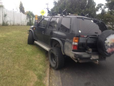

But for now, thoughts??? also a couple of pictures of my rig, the one with the spots is how it is at present. shes no premadonna, and has her scars. but. for 2grand, shes serving me well with just over 30000k since i bought her 14 months ago

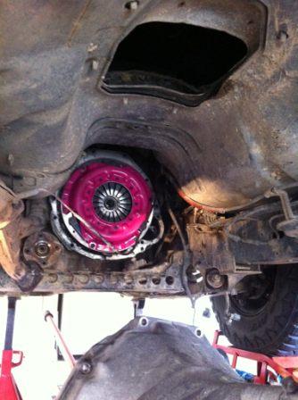

- shiny new clutch installed. Safe to say the old one was poked. Could barely get up the on ramp to motor way. Also, safe to say new one it brilliant. (apart from the fact ive chewed through a set of rear tires from actually having a clutch of some sort..) but its defiantly been my savior and other that i have snatched out.

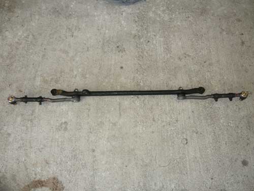

Any way here are some pictures of the new setup.
The way I have hooked it all up. may wear. But for now its brilliant. I drive it everyday and it doesn't seem to be loosening off at all.

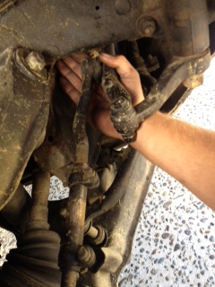

- Drivers Side. heaps of clearance everywhere. all works a treat. Wof guy never even noticed. Looks pretty stock.
- draglink.JPG (42.53 KiB) Viewed 7535 times

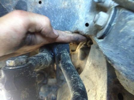

- here's my idler, simply braced with a piece of angle. works a treat. and has taken a few hits from rocks, and trees, seems to protect the idler from that aswell.
- idler and brace.JPG (30.64 KiB) Viewed 7535 times

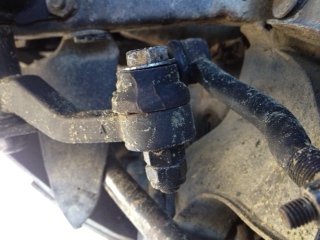

- here you can see what I have done with the joint. Instead of drilling out the hole and ruining any chance of using the standard Navara kit on it or something else. I simply made a brass bushing out of an old tap. and then put some copper water pipe from work through the centre to really tighten it all up. then a high tensile 12mm bolt thorugh the lot. With a nut, and a nylock on the bottom to lock it all in tight. Without sandwiching the joint too much. (didn't have any castle nuts. this may be the next step. but shes tight as a ticks A@# for now)
- tre.JPG (36.6 KiB) Viewed 7536 times

I run the Maxxis Bighorn MT762 32 x 11.5 x 15 on -12.5 offset rims. 2inch body and 2inch suspension lift with no guard rub at all. They do rub on the chassis rail very slightly on full lock, but just adjust the stops.
With this size tyre they put a great deal of pressure on the standard steering setup. Make sure you look into strengthening the steering as well.
Had a WOF inspection today. We went over everything very carefully and after almost 12 months I can tell you the only thing in the front end to show wear is the idler arm bushes. These have been replaced, but they only had a tiny bit of play in them.
DON'T run the front ends too high. You will be replacing parts all the time.
Re: Terrano steering, here we go again...
I used to run 33x12.5's on -19 rims and they didnt rub with 2 inch suspension, 2 inch bodylift.
Only time it rubbed was at close to full flex and turning on firewall, guard was cut a little bit (well dented lol.)
