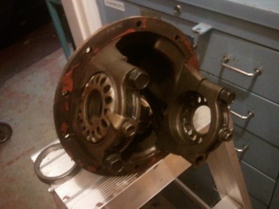

I've got a dismantled diff head that the crown wheel buggered out on. It was a 4.5 open diff in a 85 hilux can measure the bearing size if need be. If it will suit what you're after, I can bring it up next weekend. Price would be a dozen Macs gold

nstacey wrote:I've got a dismantled diff head that the crown wheel buggered out on. It was a 4.5 open diff in a 85 hilux can measure the bearing size if need be. If it will suit what you're after, I can bring it up next weekend. Price would be a dozen Macs gold
Nick
Sweet, pm sent.

churchill wrote:nstacey wrote:I've got a dismantled diff head that the crown wheel buggered out on. It was a 4.5 open diff in a 85 hilux can measure the bearing size if need be. If it will suit what you're after, I can bring it up next weekend. Price would be a dozen Macs gold
Nick
Sweet, pm sent.
Pic attached as dug out of my spare parts box. I couldn't find the 4th bolt that holds the carrier in place. Pm reply sent
