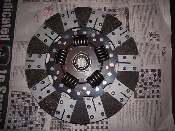

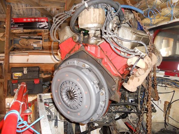

Clutch, often a bit neglected and not really thought about, even though it hadnt done much work on a rebuild the 12" chev clutch couldnt clamp up tight enough and would spin up with hard work so I stuck a centreforce clutch in with centrefugal counterweights on the diaphram and a dual friction clutch plate... it bites real good :D
