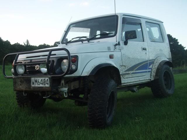

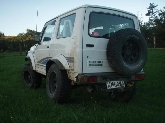

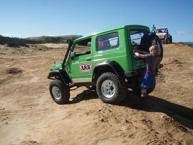

Here are just a few photos. These two were taken today after spending the day clearing tracks for the Northland WC.
End of the day next to suzookyman,
Awesome flex
New lights make a big difference
Been having heaps of fun just driving it, done over 300kms already:shock: It has been performing faultlessly and the conversion was well worth the effort, and having disks is really good.

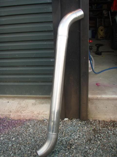

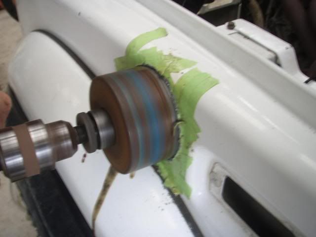

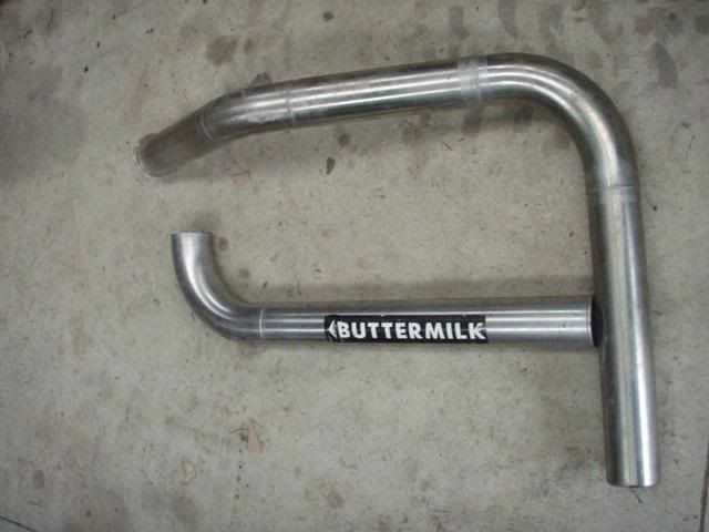

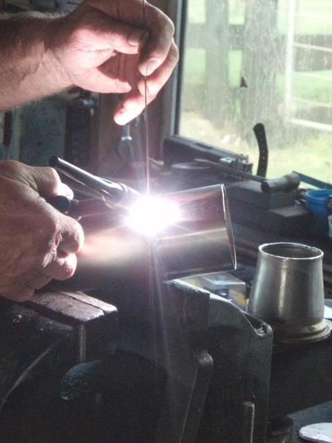

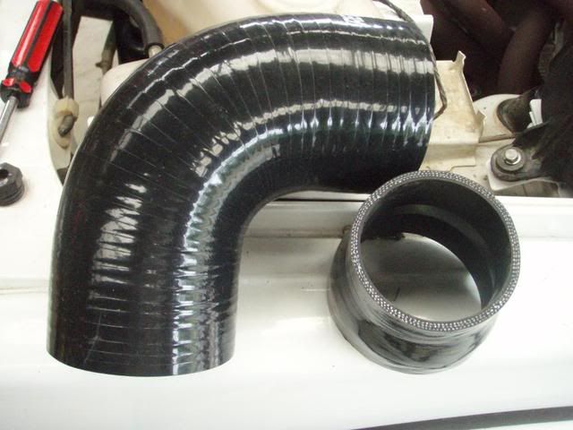

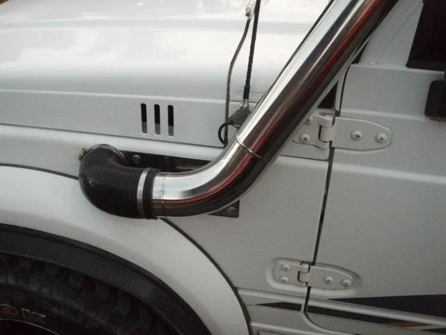

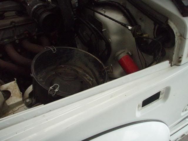

Spent today making up a new snorkel for the Zook.
Made it out of 3" stainless pipe, wanted to make it out of 2 1/2" but my mate didn't have any.
It still came out alright, cost me all of $28
Air cleaner box, the inlet is facing towards the guard.
Stainless pipe I got,
Fittings,

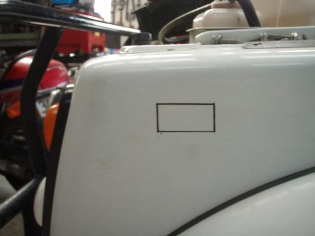

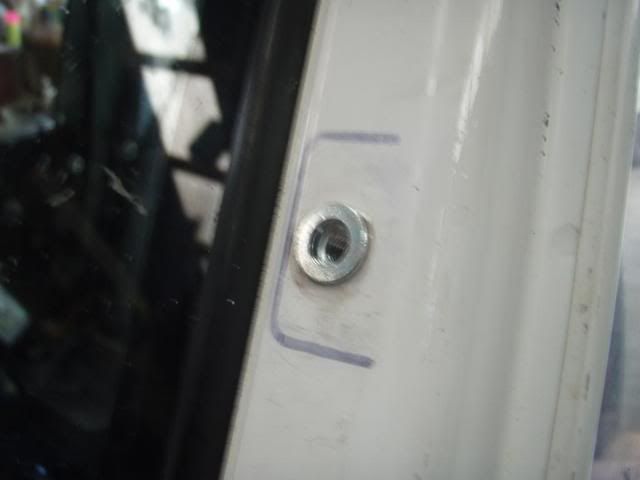

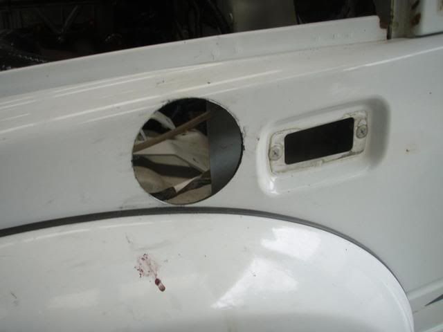

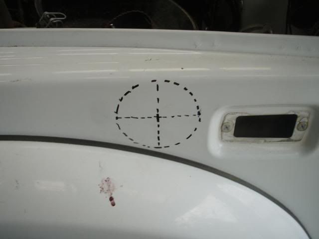

Where the new hole goes,
Drilling the hole, didn't want to stuff this up
Came out good, filed the burs off and painted the bare metal to stop it from rusting.

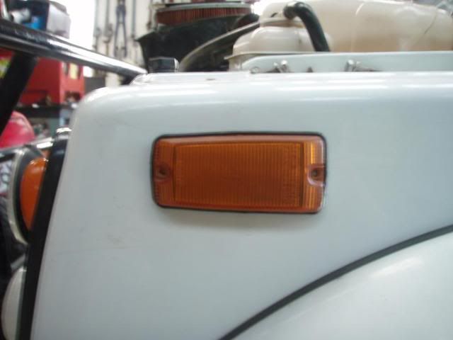

Had to relocate the indicator to the front, the other sides indicator had already been moved when the previous owner had mounted the old snorkel on the other side.
New hole cut out
Test fit,

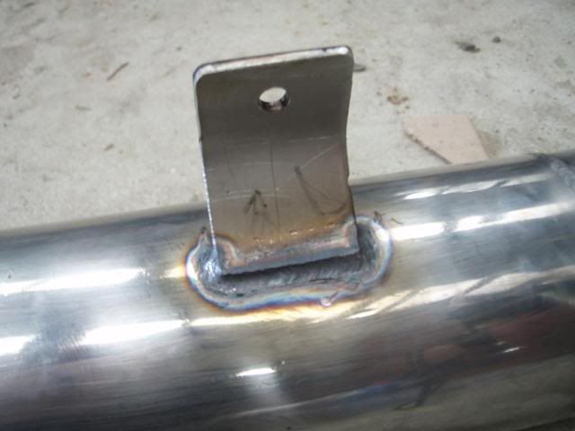

One of the mounting brackets
One of the mounting points

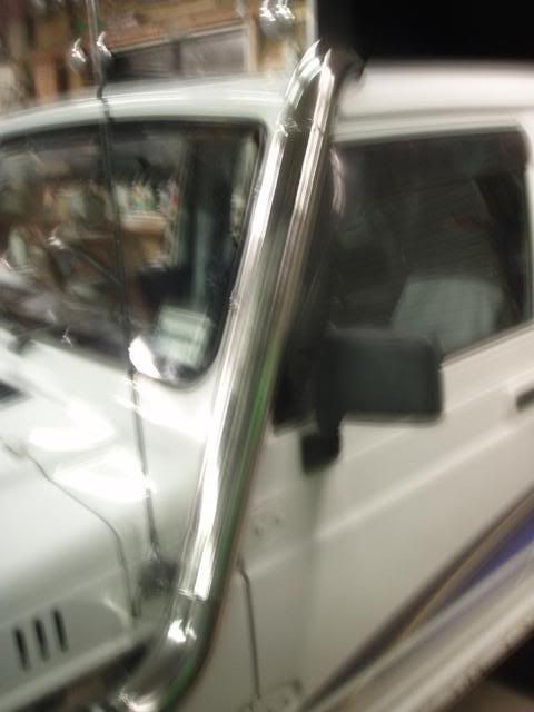

Ready to be polished
All done, sorry about the blurry picture, but this is when the camera died
Will get some more photos in the next few days.

Re: 97 Coily Samurai
rofl...!!! i've seen this stuff before....
good form on the snorkel, very tidy guy.. *thumbs up*

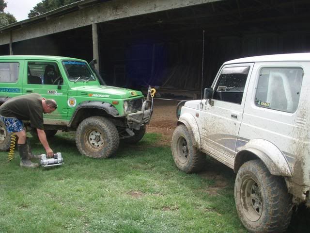

The green machine has been having a few mods to the rear winch which might help us out sometime

niblik wrote:rofl...!!! i've seen this stuff before....
Lol yeah, I was tempted to leave that sticker on there. I knew there would be some people that would recognize it
ha ha another Dairy Worker, I've still got some of that left in my shed, from when I put a snorkle on my old MU
should have left the sticker on, looked halerious.

WRNGLR wrote:niblik wrote:rofl...!!! i've seen this stuff before....
I got the stainless off a mate of mine who worked there. He has heaps of it

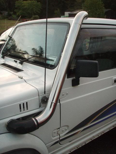

Here are a couple more photos of the snorkel,

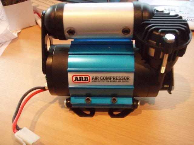

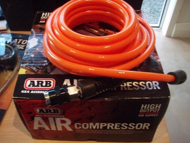

Also got a few goodies today
Will probably fit the compressor this weekend.

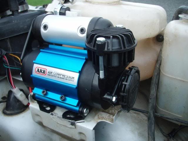

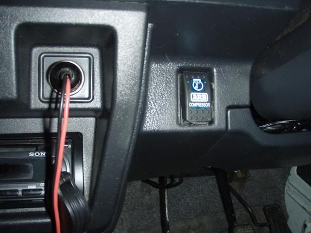

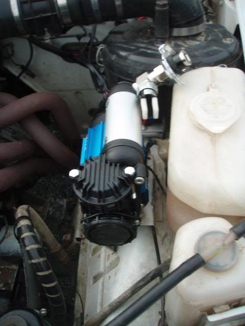

I had a good weekend.
Got a new warrent for the Suzuki and I got my new compressor fitted and going on Saturday,
I fitted the switch where the old choke hole was in the dash for the choke cable.
That all I managed to get done to it. Spent the rest of the weekend getting bits ready for the winch truck for the Northland winch comp next weekend. Can't wait for the event it should be awesome

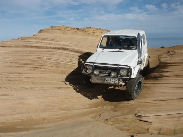

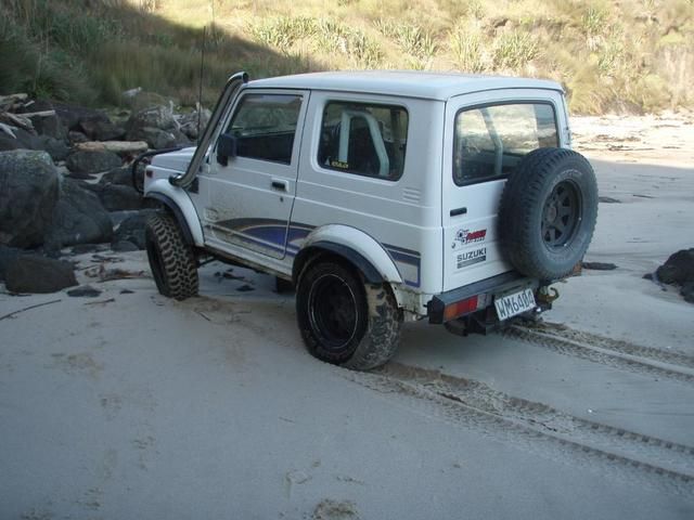

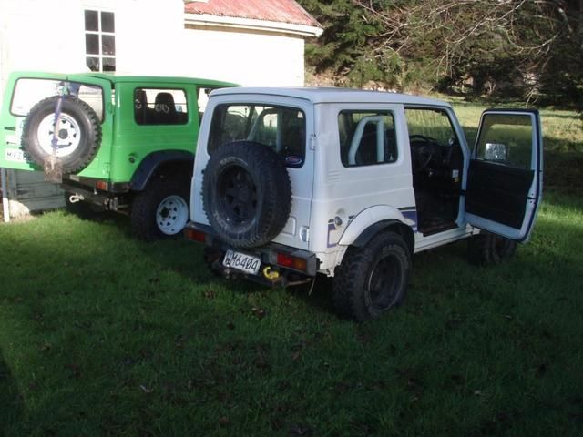

Had an awesome weekend up north with the Whangarei 4wd club at our yearly Mitimiti run.
Was the first real trip I have taken it on with the new motor and it performed faultlessly

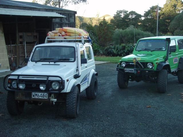

Friday night after work with suzookyman ready to leave my place
On the Rawene ferry,
Saturday morning looking out from camp

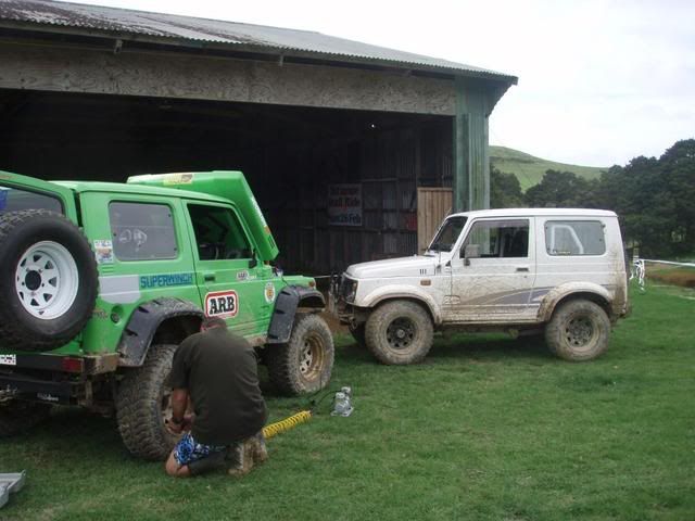

We had a wide variety of trucks ranging from my Samurai up to a winch challenge truck and Dr_PC's trails buggy.
Looking at camp

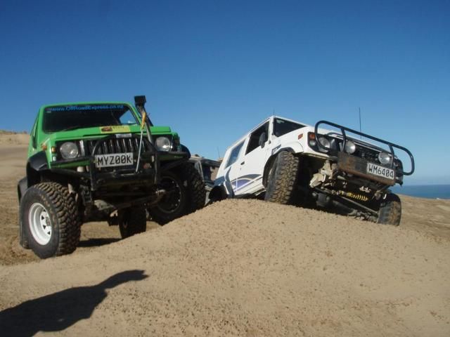

Poser shots with suzookyman
Marty managed to break a cv in his Jeep, he drove all the way back to Wellsford and back to get a spare that he had sitting on his bench

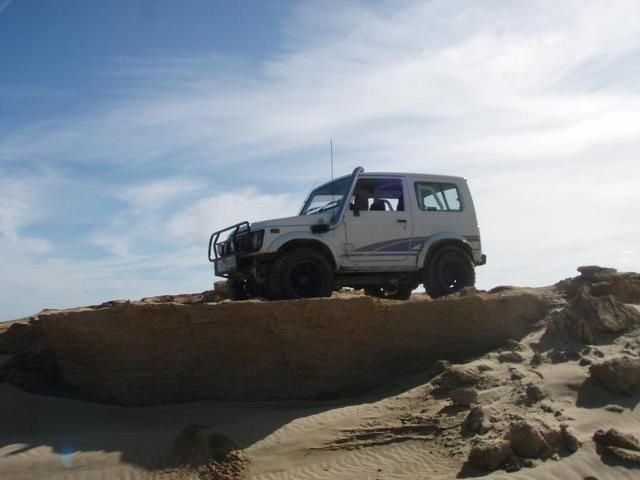

Up in the sandstone,
Another coily
Looking at camp
Another coily

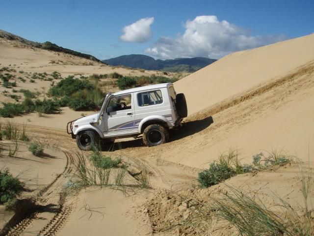

Photos from Sunday,
Dr_PC decided to have a little lay down while playing

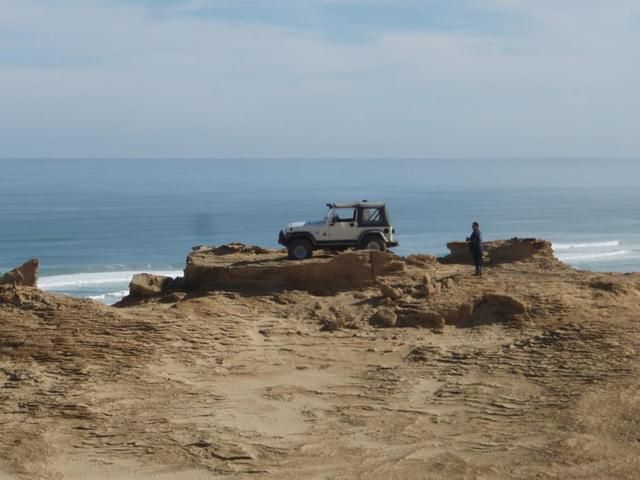

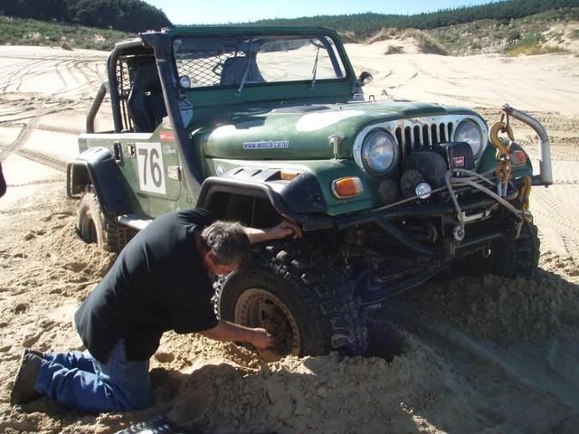

Kanes Jeep

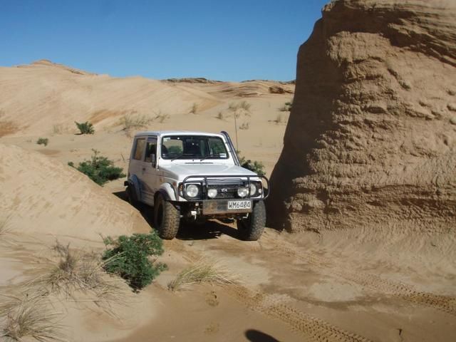

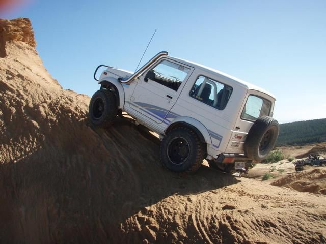

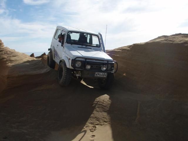

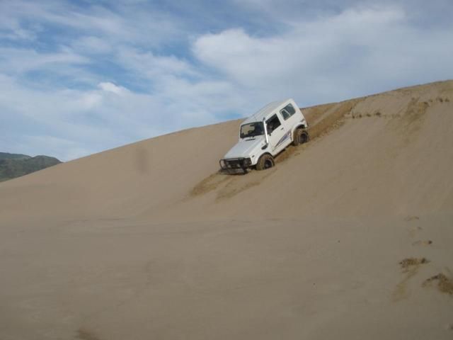

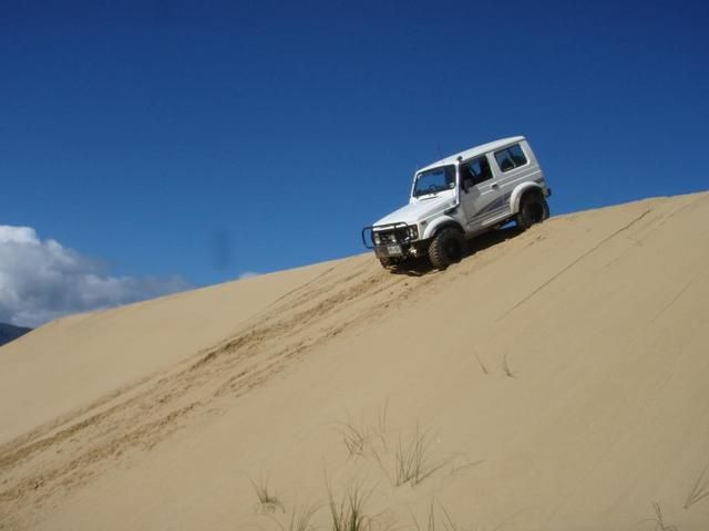

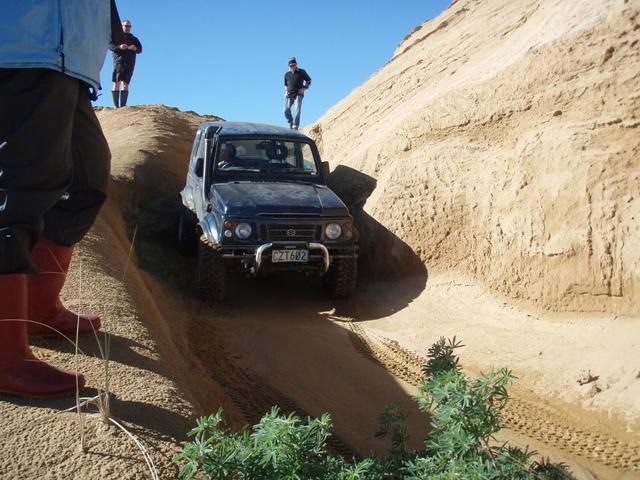

Didnt make this hill climb (I blame the Jeep that went before me and made big holes
Playing in more sandstone
Last sand dune for the day,
Back home, all cleaned ready for work tomorrow,
Kanes Jeep
