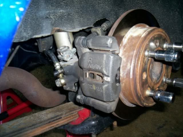

I used Nissan Maxima rear calipers with handbrake on my surf

Was going to edit other post but I have just checked and I ended up using calipers of a Nissan Bluebird RNU12. Nissan rotor thickness 9-10mm
Used solid front discs on the rear
