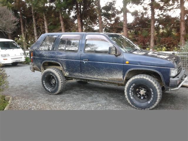

Only go as high as you have to. The biggest improvements to my Terrano was the body lift which gave me a better approach and departure angle and extended shocks all round with some "mods" to the Ifs to get a bit more flex out of it.
http://www.imagebam.com/image/9ca53e146421054
That was with the rear sway bar in, I find with the rear sway bar out it flexes too much in the rear(is the possible!) and is unbalanced front to rear.
Its not a lot of flex in terms of a solid front end, but its probably close to the best "stock" IFS flex, I'd guess Sibainmud's would be the same.
Highly underated offroad the Terranos, good size, wheelbase and weight combo.

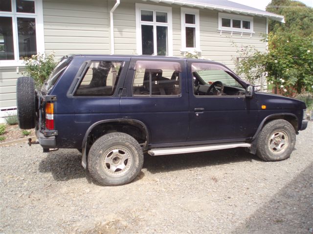

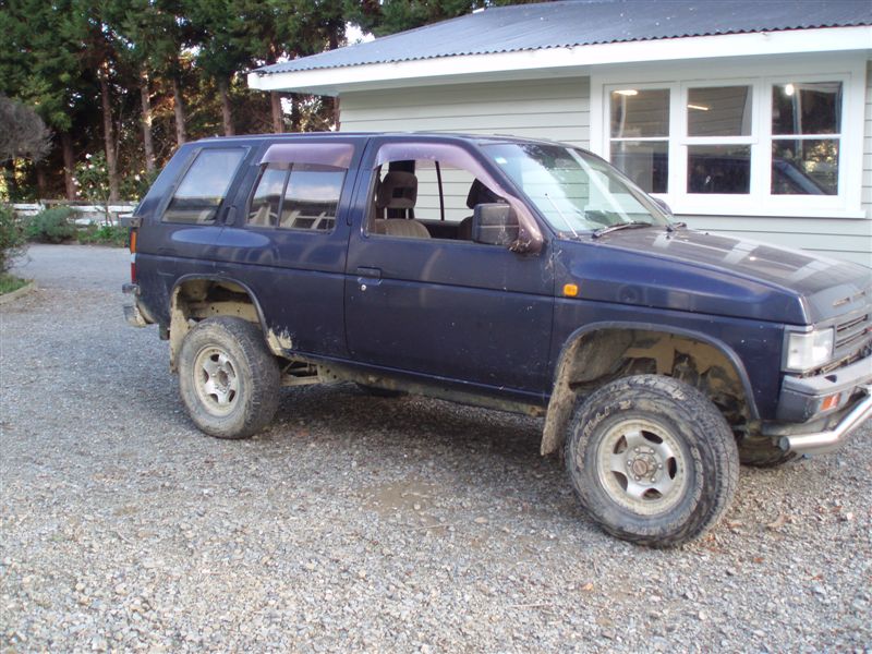

Just for the record, here she is on a wintery south coast trip, Before my dance with the bank and wire fence.......

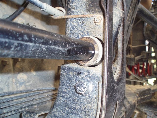

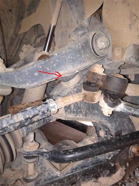

OK finally have some time to do the suspension tomorrow. Got some new Cobra springs with an extra 50mm height than the originals.
Just have a couple of questions....
1) I notice that under the existing springs there is some thin rubber rings, probably to just stop metal to metal wear. They look fairly worn, so should I replace these, and with what? I probably have an old rubber car mat I can cut up.
2) I was looking at the torsion bar adjustments and wanted to check based on my pictures below. Are these adjusters already cranked almost all the way up already? There is a heck of a lot of thread already showing.
Not sure which way they wind to increase front height.
(Ignore wet look, I've just sprayed a bit of WD40 around on the threads)
Re: Operation Terrano
You wind them in to go up, yes they are wound nearly right up. to go higher you need to slide the bars out of the anchors and re-index them about 2 splines
Pretty easy once you get the hang of it.

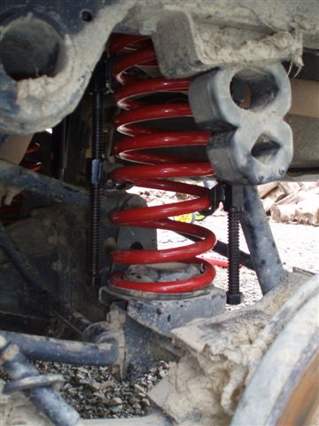

Right the new springs are in.
What a right pain in the ass to get those in. A word of warning for anyone wanting to try this.
- Give the underside of the vehicle a good waterblast the day before you start.
- I found that if the spring compressors are not located in the right place they will hit the spring mount points. Even more difficult to guess the right spot to set them when inserting the new springs.
- Remove the wheels, sway-bar and shocks, as it gives you a bit more room to get a socket on the end of the spring compressors and throw things about if its not going your way.
Anyway, the finished product. Exactly 50mm higher than original. Nice job Wheel Crazy Thames. Next I'll re-index the torsion bars, but for now I'm quite liking the hotrod look

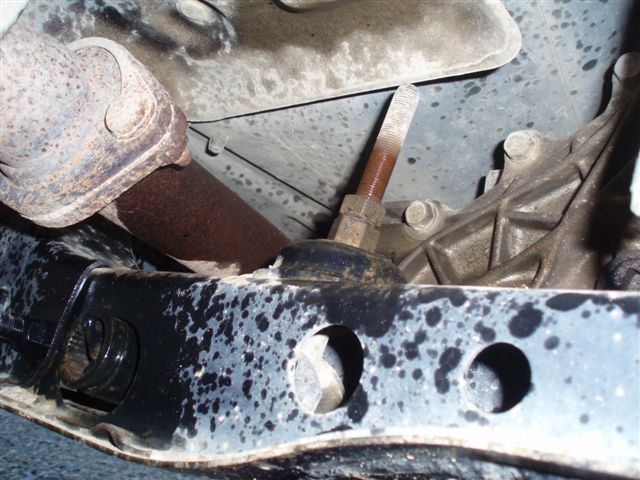

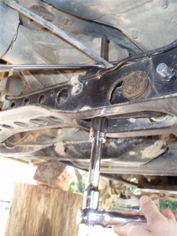

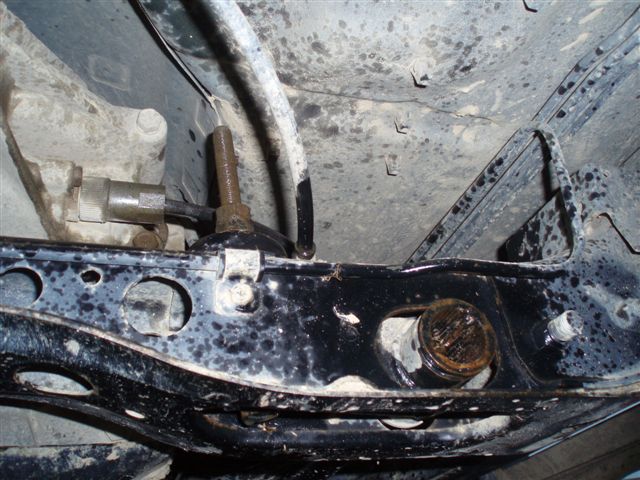

OK, so I’ve finally got around to doing the torsion bar adjustment a couple of weeks ago. Looks much better now. Was fairly straight forward and no real problems encountered.
Here is the procedure: (You can perform these steps to each side as you go or repeat once one side is completed)
1. Jack up the front to get both front wheels off the ground. This releases the tension on the torsion bars.
2. Give the threads on the torsion bar adjusters and the spline a squirt with CRC or WD40 just to free them up a bit.
3. Put a mark on the adjuster and torsion bar so you know what spline they were originally lined up to. I find giving it a scratch with something sharp and then putting a bit of white paint into the scratch works well.
4. Next undo the top nut completely off the thread. Then start unwinding the main nut, all the way off the thread. Pull out the adjuster thread/bolt.
5. Now you will need to remove the C-Clip, washer from the adjuster. If you don’t have some C-Clip spreaders I found a couple of decent sized screwdrivers did the job. One to hold the C-Clip from sliding around, and the other to gently tap the other side of the C-Clip so it pops off the adjuster.
6. Next you will need to give the adjuster a good tap so it slides off the torsion bar spline. You will find that the back of the adjuster has a grove in it which stops it from sliding back as the cross-member locates into this. So you will need to pull the torsion bar down a bit. My torsion bars were original so needed a bit more force to get the adjuster off. I found a smack with a good sized pin punch on the adjuster near the spline did the trick. The adjuster will slide right off and you can pull it right out of the cross-member.
7. Next give all the areas a good clean and grease. I put a thin smear of grease around the spline and seating point for the half moon washer.
8. Now slide the adjuster back onto the spline at 2 or 3 spline positions from where it originally was (note white mark positions). When you put the adjuster threaded rod back into position you just need to make sure you have enough thread showing at the top so you can get the nut back on. If your torsion bars are old and original you will find that they have stretched a fair bit / increased in elasticity. So from no tension to tensioned (at desired height) you may find that you have the adjust nearly the full length of the thread.
9. Put the C-Clip back into position.
10. Put the adjuster bolt back into position and start screwing the main nut back on. You will find this nut needs to be wound a fair way until there is some real tension.
11. Lower the front of the truck back down and measure from the top of each rim to bottom of the guard to get the heights equal on both sides. When adjusting each side, make sure you jack the front wheels off the ground.
12. Take the truck for a spin over some rough ground to settle the bars in and the measure and readjust if required.
Happy trails....

Light bulb moment......
While measuring for those shocks in the rear, I reckon that if I unbolted the shocks and jacked the back of the truck up, I could probably install the new springs without having used spring compressors......Now that would have been much easier.
fullthrottle wrote:Light bulb moment......
Bingo
I was wondering why the big write up on your method
Closest I came to using spring compressors was a load locker tied through the spring while the truck is on the ground. Then you don't have to jack it up so far
Was good reading anyway

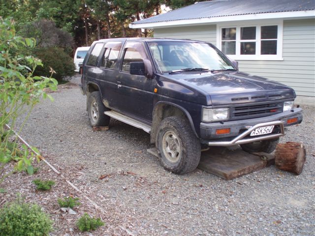

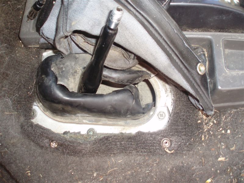

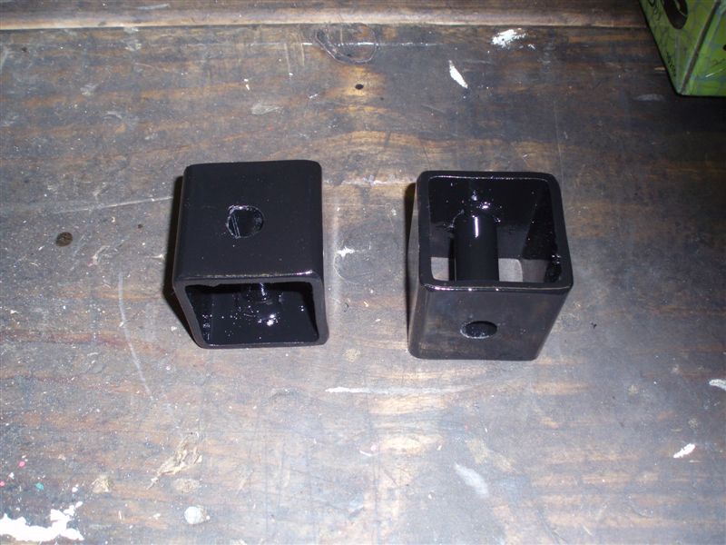

OK, the body lift is now pretty much done. Thanks to Simon and TAZ for your help. Still have the two rear bolts to sort out, bumpers to adjust, handbrake cable to adjust and drive shaft loop mounts to extend.
Actually doing the body lift was fairly easy. The hardest part was taking those side steps off and having to remove the seats and lift carpet to get to the bloody bolts.
Here are some pics:
So what did I do to get the job done.......
1) Remove botom section of radiator cowling. This will allow the radiator to move up with the body while the fan stays in the same position.
2) Remove driveshaft loop. This will stop you lifting because it is bolted to the body and loop runs through the center cross-member.
3) Remove front bumper, as the slots in the body where the bumber mounts pass through are not long enough and will stop you lifting the body.
4) Unbolt and remove all 5 mounts on one side.
5) Unbolt and remove the front and rear bolts on the other side.
6) Jack up 1st side and insert lift blocks and bolt loosely into place.
NOTE: 150mm bolt for rear is just enough.
7) Do the same for the other side. and tighten all round.
Once done....
Check the petrol filler pipe has shifted OK with the lift.
Extend/adjust the handbrake cable
You will need to cut and remount the bumpers if you want them to sit in their original positions.
Trim the bottom rubber boot plate of the 4WD selector.
Add blocks to the driveshaft loop mounts and refit.
Here are some pics:
Once done....
Looks alot better. Good effort
Nice work.
Ph 0212078472
Ph 0212078472

Took her out for a spin today and holly cow, she is completely different. Rides nice and firm with the shocks, suspension and bigger rubber. Careful on the corners, she likes to try taking you for a spin.
Those 32's with a -12.5 offset rim are a perfect fit under the guards. Can't go any bigger with those rims without hacking the body up. Just have to remove the flaps and trim as they do nothing for the tyres now anyway.
Maxxis Bighorn MT762 32 x 11.5 x 15 for the best price I could find of $299 each.
fullthrottle wrote:OK, so I’ve finally got around to doing the torsion bar adjustment a couple of weeks ago. Looks much better now. Was fairly straight forward and no real problems encountered.
3. Put a mark on the adjuster and torsion bar so you know what spline they were originally lined up to. I find giving it a scratch with something sharp and then putting a bit of white paint into the scratch works well. ETC....
What I've found is it's easier to do it on the front of the bar....after you've backed the adjusters right off, undo the 3 bolts that hold it to the lower arm, and slide it back down the bar, turn it however many splines ya want, then bolt it back on.
Nice job though, she looks good.
dont forget to get a brace made up for your idler arm, with save you heaps.
i had 2 inch suspension and 2 inch bodylift, which seemed allright.
but then something went wrong in the front and i decided to put a solid axle under it.
also, with my front the Top A Arms would hit the shocks, so watch out for that, as aparently it can fail a warrant.
i had a problem where i lost the nut on the back body block, which was a pain because it was somewhat lost in the bit that drops down. after about an hour i found it. what a pain though....
Dirtydog wrote:also, with my front the Top A Arms would hit the shocks, so watch out for that, as apparently it can fail a warrant.
New top control arm bushes solve that problem
