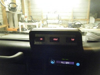

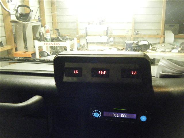

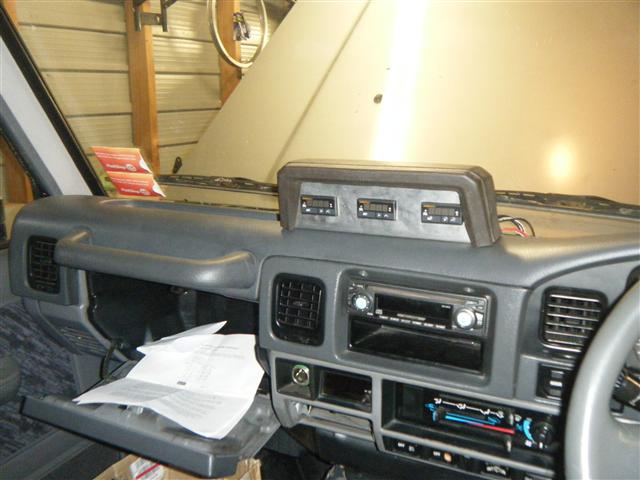

So installed the guages, made an alloy facia (spelling?) plate that attaches to dash,
then cover sits over the top of gauges and makes it look tidy.
forgot to take pics mid way through, so just the finished product pics for this.

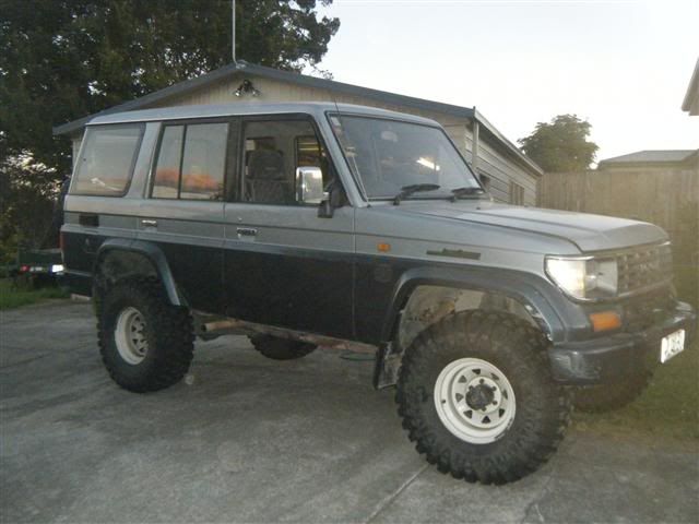

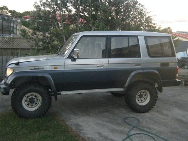

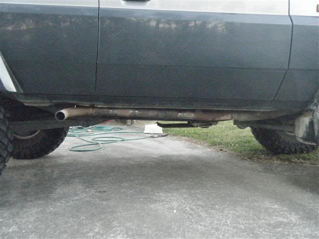

fitted new rear springs. its now higher in the arse than in the front. yay, no more saggy arse. (wish it was that easy for all my rides!!!) need to put in the bigger shocks too.(the current fronts.) but cant do that till i put in the new front springs and shocks. and finished up my temporary exhaust.(the one ill have till i have enough moolah to make a nice one.
its made of standard pipe cut to bits and welded back up. aint all that pretty, and illegal but it works well. need to adjust lf wheel bearing at some stage.

My lovely exhaust.
these 35 creepys starting to look small. anyone ran 36" triple block simexs on their prado?
