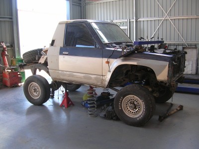

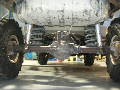

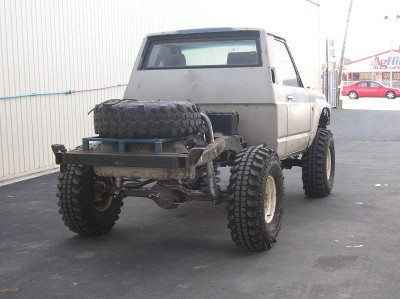

Hi Guys

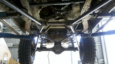

i have a Nissan Safari LWB
This has been cut down to a ute (By previous owner)
Then i shortened its chassis
Fitted triangulated 4 link in rear
Fitted 5 link in front with panhard rod
Slipped the VG30DETT motor an Safari auto.
The motor is twin turbo an twin water to air intercooled.

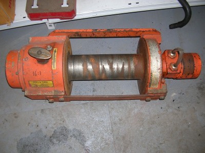

Have hydraulic superwinch to go in. hopping to run pump off crank pulley.
Have spent many hours on it an many more to come.
will try to keep update as i go.

Nice :D
Interesting choice of vg30dett. Fit in easy enough?
Welcome to the site, Keep them pictures and details coming :D

Nice fab work on the the chassis link mounts. 8)

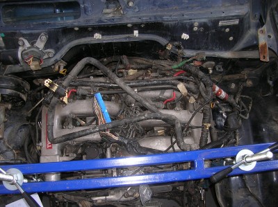

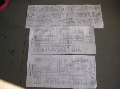

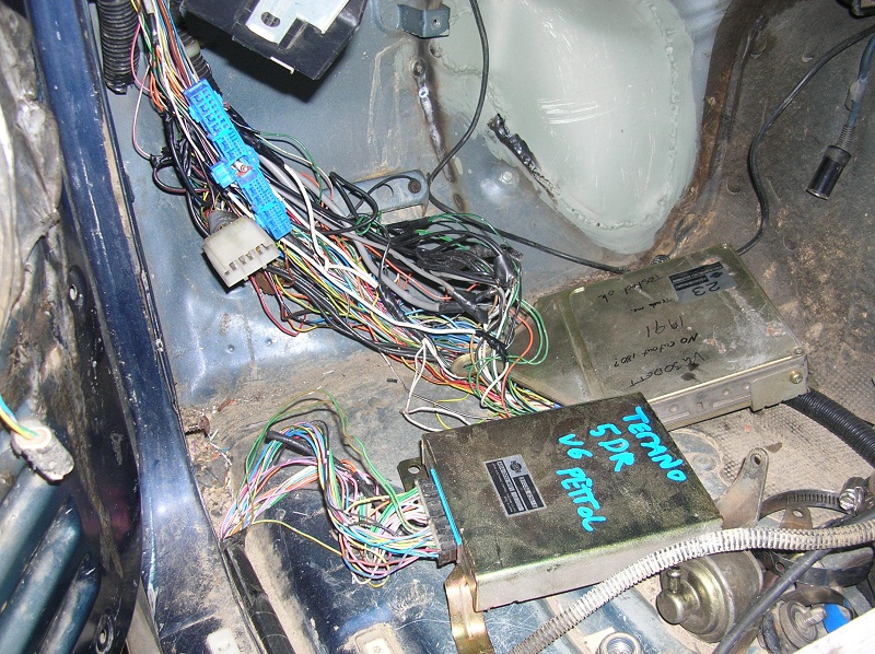

got ta love the wiring side.got to get the safari loom to talk to the 300zx motor an then to the v6 terrano auto ecu.

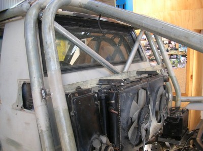

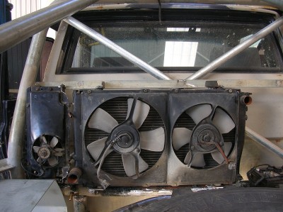

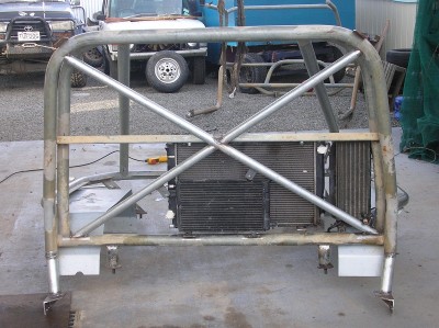

unsure on how much cooling will be needed so mounted 2 radiators back to back. didn't want to loose vision with taller radiators.need to look for a inline water pump now.

sure you'll have enough LITTLE JAPANESE HORSE PWR :roll: to run all them fans ! :mrgreen:
nice wiring diagram there craig you"ll have your crayons out drawing on the floor next :lol:

Haha talked to a chap the other day who's a wiz on these motors an was quietly surprised to here what power can be reliably extracted form these motors. who knows tho. i have allowed enough room for a v8.
also need crowns with different colored traces so it would be easier to follow them.

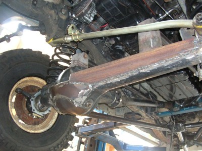

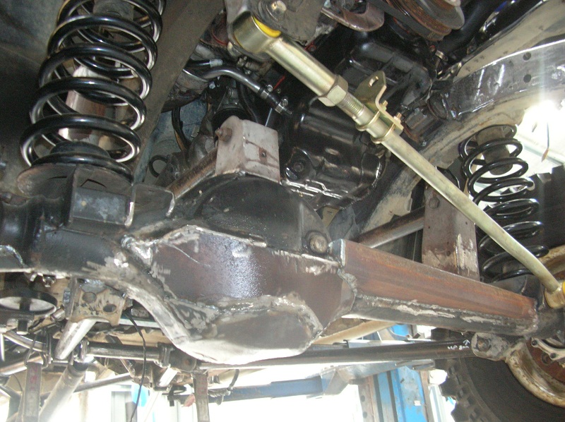

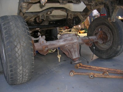

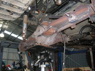

Found a bit of enthusiasm. blew the dust off the truck an welded on some diff bracing.
Front. had to make strong as my have shaved a bit to much off underneath.
Back diff. hope i left enough to get locker arm out.

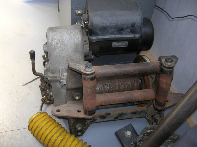

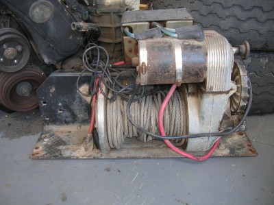

still working out an doing alot of thinking on winchs, going to run this hydraulic,an run pump off the crank,
Craigs4wd
Posts: 89
Joined: Fri Jun 01, 2012 12:00 pm
Location: Omarama
Re: Nissan Safari LWB shortened an VG30DETT fitted.
Post by Craigs4wd »
But undecided on which electric winch is best.

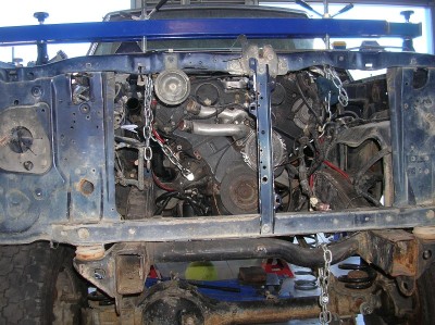

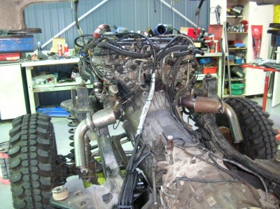

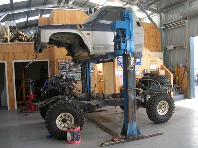

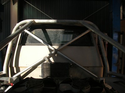

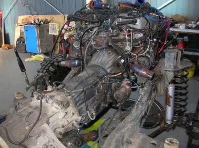

time to remove body an bar work to run an secure the fuel lines,trans lines,and brake lines every 300mm for cert. also to get an un welded mounts an an bars from the top.
now time to remove engine an weld up mounts and also. pull some unneeded crap off motor
fuel an trans lines run.
all external bar work off.
rear bars an coolers removed

little bit of exhaust work an heat shielding. Cert mans coming today so will get him to check progress an make sure we keep them happy.

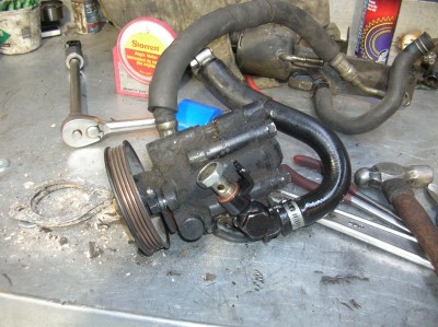

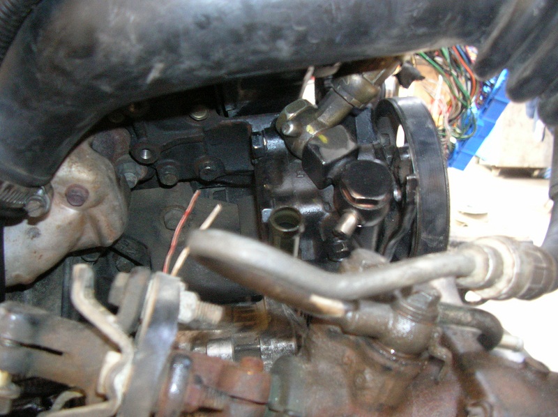

The Nissan VG30DETT twin power steer pump removed (one part for power steering an the other for the 4 wheel steering which the cars have.)
another one adaptered which appears the same physical size as the Nissan patrol one.
This one come off a nissan VQ20DE i have  for parts
VG30DETT one with 2 High pressure out puts.

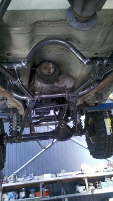

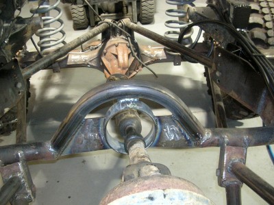

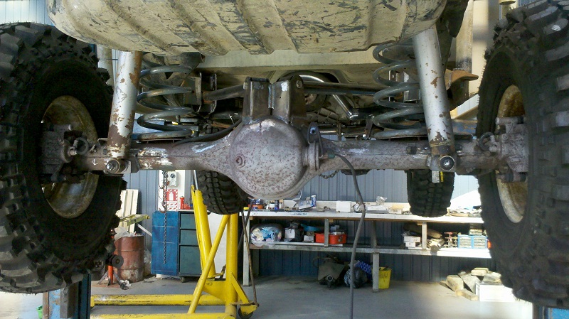

Today while i had some spare time i made up myself a drive shaft loop and also wanted to strengthen up the cross member.
Post by Big »
now thats cool :mrgreen:

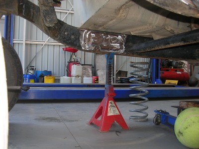

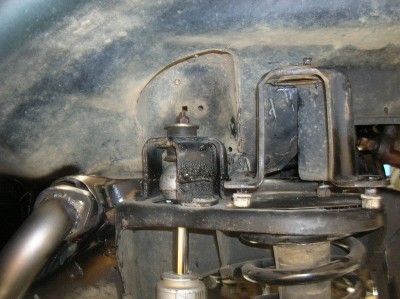

Post by Craigs4wd »
also found i needed to lower shock towers 50mm to allow the springs to be just captive an as i have to bring bump stops down to prevent new steering system hitting panhard rod mount, i didn't want to loose shock travel.
