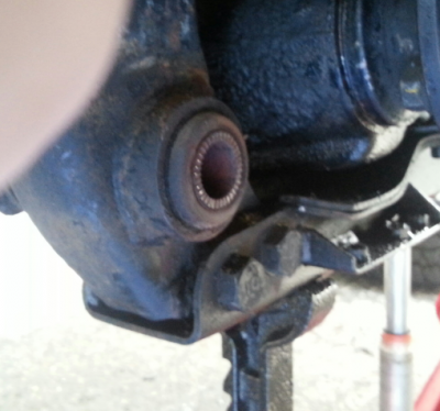

Edit: added pic of rear bush. Seem i may have double posted some how. My apologies fir this.
Hi.
I have a 87 pajero 2.5D turbo 3 door. Im tying to replace the front left control arm bushes . I have managed to change the front bush that is on the control arm. I did the by pressing it out using a vice. The rear bush is on the chasis and im batteling to get it out . How do i do this ?
Thanks
Greg

Drill the rubber between the inner crush tube and the out casing out , knock the inner sleeve out with a hammer , cut the outer sleeve with a hacksaw and use a punch or something similar to tap it out , to put the new one in you could use a big g-clamp or a porter power hydraulic ram.

nztimr33 wrote:Drill the rubber between the inner crush tube and the out casing out , knock the inner sleeve out with a hammer , cut the outer sleeve with a hacksaw and use a punch or something similar to tap it out , to put the new one in you could use a big g-clamp or a porter power hydraulic ram.
Thanks for the tip what drill do u recommend. I tried it on the front bust and broke the bit , but i was using a wood one what was on hand at the time.

No probs , obvisouly the better quality the drill bit the better it will work but any steel bit should be sweet

I ended up following the earlier instructions wich i confirmed discussed with a local mac. Rather messy and time consuming.
Now the quetion is how do i get the new one in lol.... it tempting to hammer it in but that would be nasty. Im thinking of using a large vice , problem is i will have to ballance it on a jack lol. I dont have transport to get around to locate the parts to make a tool to push it in.
Any ideas ?

Use a long bolt or some threaded rod and two nuts with washers. Wind it in as far as the set up will allow and carefully use a big socket that fits perfectly around the outer sleeve of the new bush and tap the rest of the way in. Don't hit it too hard as the sleeve may "mushroom" and never fit all the way in. Would pay to spend the time cleaning the chassis hole out with emery paper or sand paper to give maximum bore diameter to start with.
To aid the very first part of insertion, you can file or grind a small leading chamfer in the outer part of the bush
