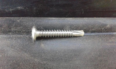

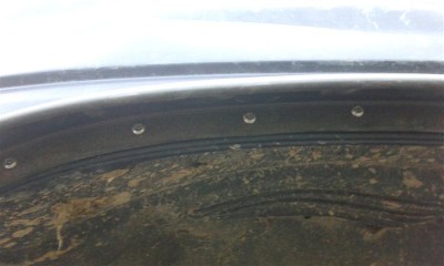

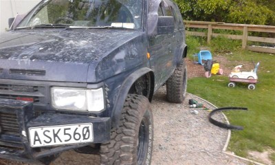

Re: Terrano guard shield-mud catchers - flares
WRNGLR wrote:not closed off yet bud we need pics of the finished article![]()
Hahahaha, well shit a brick. Has it taken me that long.
Tonight I shall celebrate, I have just put the flares on......
I've gone with the stainless steal, self-tapping screw fixing options. Not to big a head so the flares can rip off fairly easily if needed.
