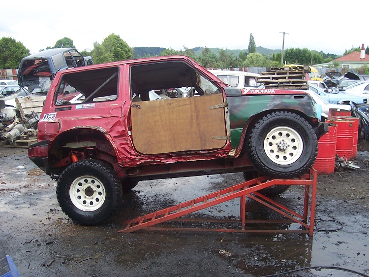

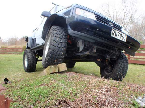

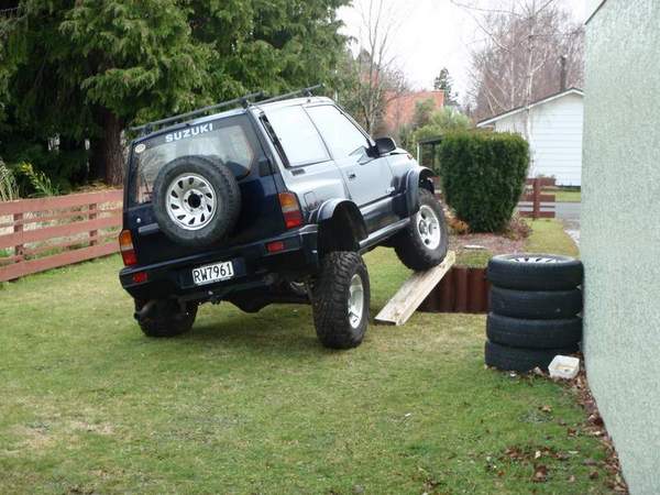

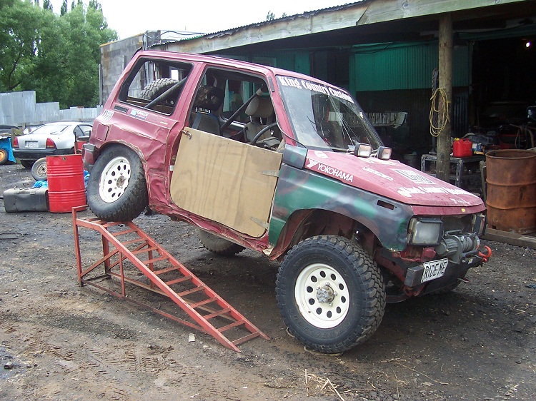

Obligatory flex shots. Testing the set up with the new additions. Checking what the current limitations are etc. The 'wheel ramp' was 900mm high.
The front has the sway bar still on it. Actually the sway bar limits the travel on the front.
I had to stop on the ramp as the front drivers side wheel started rubbing on the arch. I didn't cut any of the fender material out when I put the flares in. Just metal out of the inside.
The rear passenger side tyre still has some space to travel into the wheel arch. The spring was fully compressed, so should not hit the arches.
Note that this is without cutting the rear guards.

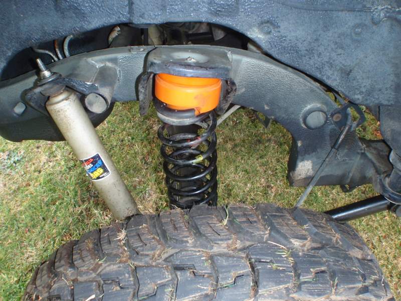

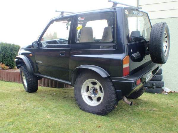

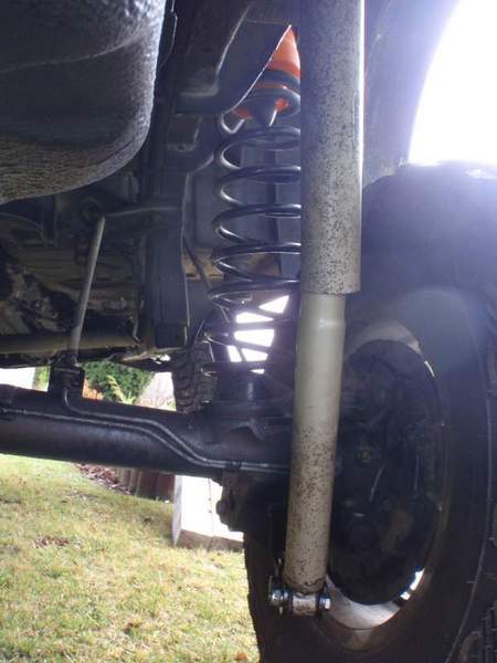

It is hard to see, but there is 10-15mm gap visible between the rear spring spacer and spring. When on the jack stands there is 60mm.
Spidertrax wheel spacers, FTS struts, Extended brake lines, Strut spacers, 15mm + 32mm Spring spacers, V6 springs. Would love to add control arms too, (and bigger springs). I bought some spring compressors to help install the springs. Big help. At full articulation the tie rod sits on the sway bar. The sway bar would have to be removed to go higher.

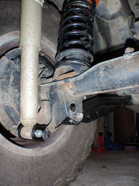

This shot just shows the FTS shock repositioners. Can't be seen in this shot, but they are also held by the pin that holds the rear control arms in addition to the original shock mount holes.
New control arms and spring angle.

how high can you get the front wheel off the ground with the other 3 still on the ground?.
Re: V6 springs + VL Commadore shocks
Right now its 900mm+.
Expect if I do something to increase guard clearance in front it will be up to 1200mm.

i mean under the wheel, it looks like you got about 500mm or so at the most, if 900mm like you say you could put a 31/10.5/15 wheel under your front wheel and still have space, on my old one i could get about 650mm with more wheel travel in the rear and no sway bars and longer shocks in the front and the front suspension was compressed ,the pics of it were on the cheap vitara lift thread but seem to of gone now. they are a awesome little 4x4 but let down by the front suspension, and the front diff is about as strong as bluetack ,i blew 7 front diffs and 1 front axle in 3-4 years of hard 4x4ing including a couple of comps,probaly still bits of alloy scattered through 42 traverse and ngaroma
. rear locker will help preserve front end, i locked both diffs in the end and was good then,need some pics of it dirty.
That bit of garden the ramp is resting on is 900mm. It might look a bit smaller as I was moving around to make the photos look more dramatic.

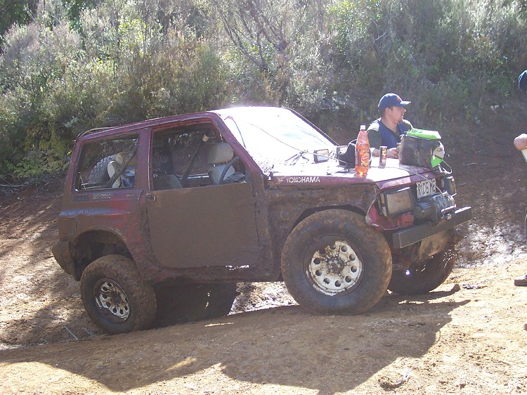

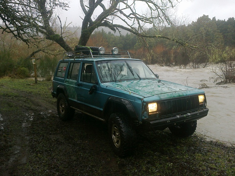

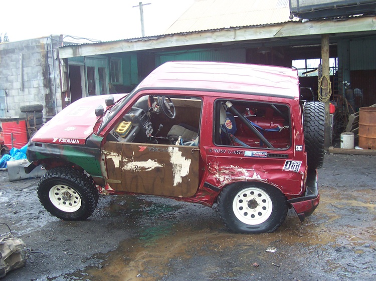

found some pics of my old gem,ramp is 620mm high .was a bloody good little 4x4.
gone to a jeep cherokee, again not road legal,i wanted a bit more room and windows so its a bit nicer for my kids to go bush,also beam axle front with coils,plus a good 6cyl motor and auto,will probaly re axle and mod the suspension after summer to make it even better.search you tube for"mrspankynz" and there is a couple of vids of my old zuk on there pre lift and lock.this is my new gem.

New control arms and spring angle.[/quote]
Are you sure the trail arms are around the right way? also have you fitted a hemi joint spacer? If so has it mad much difference?
I'm not sure if they're around the right way. Checked the fts website, and they look the same. Had to travel for work, so progress has been nonexistent. GSXR CV carbs arrived though.

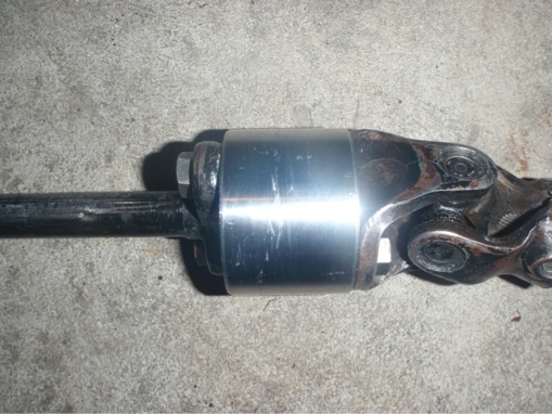

Cert guy did not like the bits4vits steering spacers. Had to get a block machined. I like it better this way.

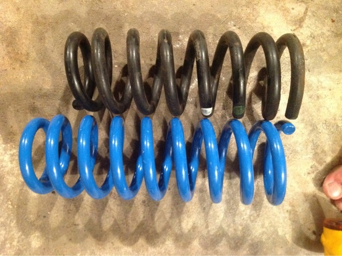

Here is the difference between v6 springs, and 3" fts ones.
I tried spreading the arms with my trolley jack, and managed to get a few mm, might go try to get some more now.

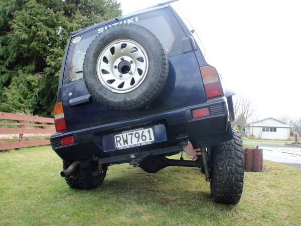

Finally got my machine back after waiting on air lockers to be made, old diffs removed, guy to rebuild diffs, then put back in…
What a difference though. On the open road I am 100 Km/h at 4000 RPM. On 31s.
Now we got 5.72 R&Ps in, steel front axle, front and rear air lockers.
The testing paddock beside the house that I got stuck in (and embarrassingly got the wife's XL7 to tow me out) I cruised through in 2wd (unlocked). Definitely much more capable now.
My gearing calcs tell me I am lower than stock. If I can work out a way to attach excel files I will put them up here..

Fully locked I noticed that she doesn't want to turn as one would expect.
Mechanic was concerned about CV angle and took the extra 1" spacers out.
BTW that XL7 is a beast. Kids and I did some skids at Tukino a while back and it goes good. 2.7L V6.
Will post some photos later. Still don't have a WOF, but certed and ready to go. need to get some pedestrian guards on the winch bar. Maybe do that today if I can.
Still got the teeny tiny stock battery, when my wallet recovers (never) will put a big sucker in.
The R&Ps and lockers remove the weaknesses due to taking a hairdressers car and sticking big mudders on it and now it is much more suitable.
My thread title is inaccurate now as the V6 springs and VL shocks are gone.
