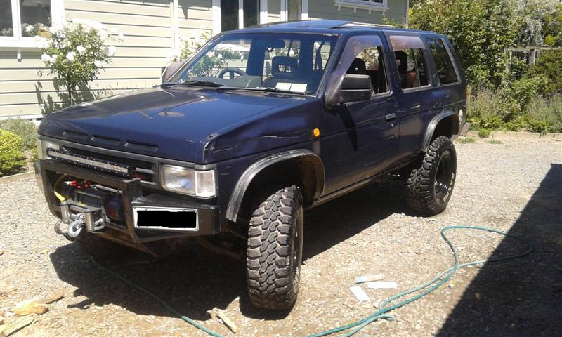

Hmmm ah yes this post. For those that are interested, will give you a bit of an update.
So the last major bit of work done was a fair while ago, replacing all the CV boots. Wasn't actually too bad a job to do in the end. Fairly straight forward with some tips and tricks from Simon.
Since then she has been on many trips, 3rd in a competition and hauling logs out.
Then, oh bugger.....
The winch wireless remote engaged and ended up splitting the winch housing. So that meant taking the front bar off and sorting that out. Thanks to Pedro and his merry band of brothers, the housing has been welded back up and you can hardly tell where it split. Nice job boys, cheers.
I've completely rebuilt the alternator as well. Just like new now for a 3rd of the cost.
So now, while it's all out I've got a few jobs to get sorted in the next week:
- Replace all the stock grease in the winch gearbox.
- Tickle up the front bar a bit and then remount.
- Put the 3inch steel snorkel on.
Then I'm finally going to give the engine a bit of love.
Here are some finer pics of her: (just for the record)

I love that front bar. Would love to put a winch on my truck like that.

That is probably the toughest looking front bar I've seen on a Terrano. I want...
Especially nice with that light bar.
Does that radiator still see some air?
If your going to go to the trouble of blacking out licence plate, may want to edit post from January...
