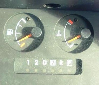

The temp gauge of my truck never makes it past 1/4. Is this normal for these engines/model of truck?
Terrano TD27eti temp gauge (pic inside)

That can be the thermostat opening temperature which is absolutely normal. TD27 thermostats are known for not closing completely and that causes them to run slightly cold. If the needle drops going down hills or take ages to get to that temp, then i would replace it otherwise leave it be.

Thanks for that. What would you consider "ages to get up to temp"?
Without timing it, I think it's around 5 minutes
Re: Mistral TD27eti temp gauge (pic inside)
5 minutes about right. As long as the needle doesn't move from there, all good.
