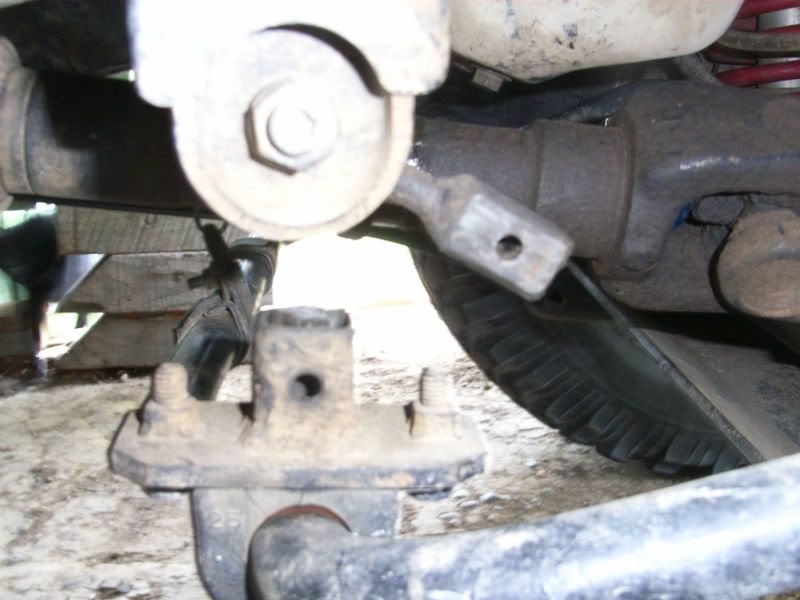

I've got a disconnect on the front. Cut chassis hangers, weld on tube top and bottom that slide into each other with a pin to hold them together for on road. Couple of springs that the bar hangs off when disconnected.

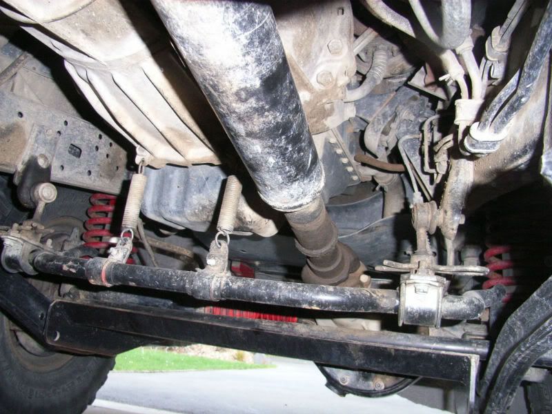

i will put a photo up tomorrow of my rear ones which is what i am going to do with my front ones.

Sorry about the blury close up but I think you can see the general idea. You can reach under and pull the pins without having to roll round in the mud, then just push the bar down a bit and swing the droppers clear of the bottom tube and you're good to go.

Drive it, Cheers. A picture makes everything seem so much easier. thanks for that.
