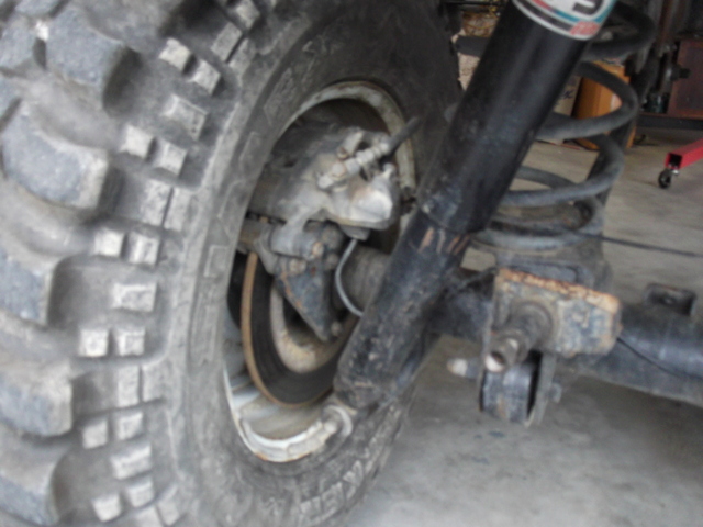

I've done the conversion using solid front rotors machined to fit the rear hub, and got brackets to mount maxima rear calipers.
there are a few options using either galant, MR2 or maxima calipers,
And either solid or ented rotors.
