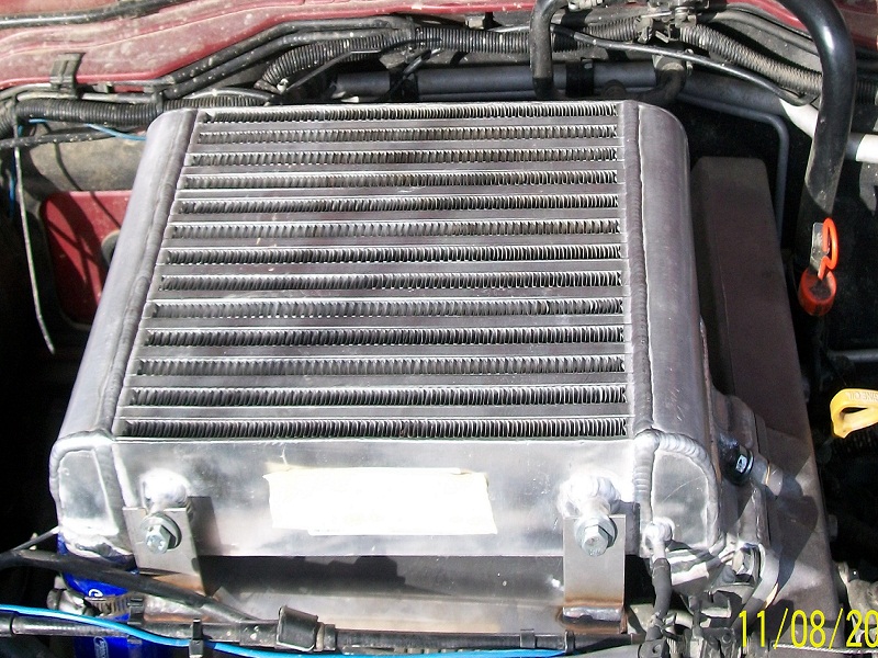

i just fitted this to my 91 80 series. just waiting for my bonnet scoop to show up.

pressy wrote:i just fitted this to my 91 80 series. just waiting for my bonnet scoop to show up.
More details pressy, price etc.... incl wether its got fans
I am going back next week to pay him and see if he can work out a price for a few for those that are interested, hoping to put a fan in and also a water sprayer?just waiting till the scoop gets here to see how much room there is.

the main issues with a top mount are, short of fitting a liquid nitrogen sprayer onto the intercooler core they just soak up the heat from the motor as they are parked right on top of it.
and.... by trying to force air into the engine bay from the top via a scoop, you are pressurising the engine bay, meaning the amount of airflow coming thru the radiator will lessen.
best airflow with a top mount is to duct air from the front channel it thru the top mount intercooler then have a vent in the bonnet for that air to flow out. you could add a fan to help that airflow at low speed but at say 50kph you'd want to turn the fan off as above that speed it will restrict flow.
it is better than no intercooler but for the time and cost involved you dont get the gains you do from a front mount.

have to agree with stx7 on this. Have done both on the same truck and the diff between the two is like night and day. Also found that they don't actually block up as bad or as quick as i thought. Still have to clean them out but no more than you would with your radiator and don't have to worry bout coolant everywere

yup yup... top mount "interheaters" v front mount will continue to bounce about. However, not everyone can front mount esp when theres two extra trans coolers plumbed in the front.

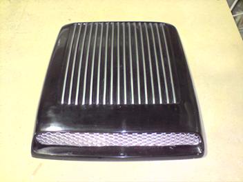

Sorry, forgot to mention that my bonnet scoop is from a 'Ford Falcon Super Roo Shaker', and is colour coded to the body paint. Looks great.
