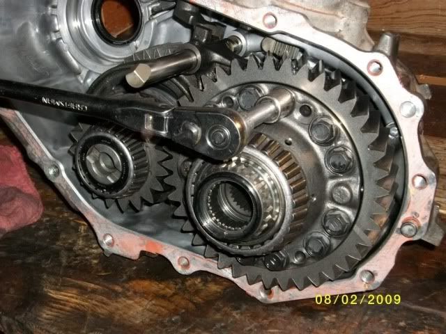

Hey guys,
The price is $300 if you're interested in getting it done.
Once you remove the back case of the transfer you will be faced with this

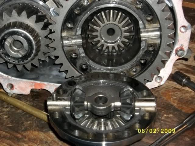

And if you send me this part Ill modify it and send it back to you (the back sidegear, spiders, the back half of the centre diff housing and centre pin)

Sounds good. I'm swapping my transfer case out next weekend so will pull the CDL out then. PM your address and account details and I'll send it down.
Re: 80 series CDL questions
Parts out and on there way to you Tu's.

It went good. Sent the parts to Tu's and got them back and installed without too many problems. Goes sweet with 4wd at the push of a button.
Way better than having to put the front drive shaft in each time which is what I was doing. That wears thin fast.
I do a lot of km's so it suits to run it in 2wd most of the time. Better fuel economy and less stress on front components.
I don't really tow anything too heavy so can't really comment on that but everything I've towed so far - quads, a good size role of cable on a tandem trailer, has been no probs. You don't even know somethings on the back.
