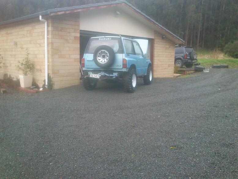

heres a pic of new silverstones got them couple weeks ago the pic is with 50mm body and 50mm suspension lift and still had clearance issues trimmed about 80mm off the back of front fenders still hits now and again off road when at full lock.
am wanting to make a winch bar for her now but looking at it cant work out where the best place to mount it to is any help or pics would be good.
think ill get onto getting a locker at sumstage and changing the gearing to as is to high range now with 31s

I saw a guy up Woodhill the other week who had made all new front body mounts and all the bar work was incorporated and all the fruit. Looked tidy as and way stronger than original.
