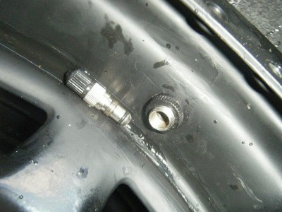

Dump valvs. Had to weld up old holes and re drill in better location.

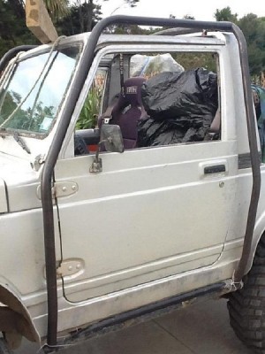

Mattrade
Posts: 386
Re: Suzuki+4age+Hilux Axels+coils+Exo Cage
Post by Mattrade »

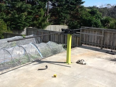

Was bizy with exo cage before i started with hilux axels. Using 1.5 chromoly.

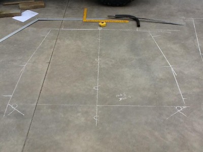

Mattrade
Posts: 386
Post by Mattrade »

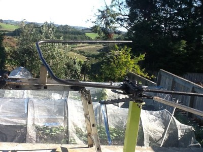

Marking out main hoop. practiced bending by building rock sliders first......took me 2 days ha ha

First bend.

More bending

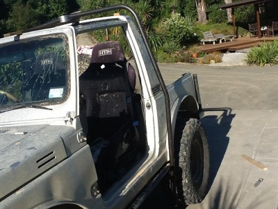

Mattrade
Posts: 386
Post by Mattrade »
Starting to take shape. Looks easy but had mean headache by the end of the day.

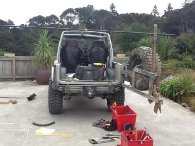

Mattrade
Posts: 386
Post by Mattrade »
So thats my build so far to date. 1year and 8 months. will keep you posted as i make more progress. Had a sick day form work and got the engine running :D

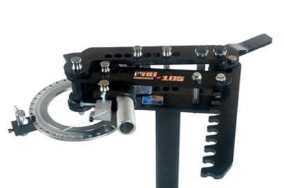

Hi.what sort of bender did you use on your cage and where did you get it from.nice job on the tube work.good to see some one on the site take the time to form main hoop in one continuos lenth.not in two bit and welding in the middle :D

Batfastard wrote:Hi.what sort of bender did you use on your cage and where did you get it from.nice job on the tube work.good to see some one on the site take the time to form main hoop in one continuos lenth.not in two bit and welding in the middle :D
Cardwell Racing Supplies in Auckland. Costs a arm and a leg but works a treat.

for anyone interested in the above, a bender with stop and degree wheel as well as 1.5" die set and 2" die set are looking at $2130. I'm currently trying to find cheaper :lol:

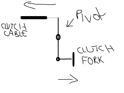

Mattrade
Posts: 386
Post by Mattrade »
Tarmac wrote:This is sweet, gd stuff.
Is the gearbox cable or hydraulic? I've seen photos of 4a conversions, also had a geeze at a 3.8 v6 but either cable clutch or auto. Im just having trouble trying to picture how fit a clutch cyl to the firewall and clear the 4a inlet manifold... the best idea I have so far is a homemade clutch only pedalbox
Using stock clutch cable
Ha ha not so good with paint :wink:
Tarmac
Posts: 335
Joined: Fri Feb 03, 2012 4:46 pm
Location: ChCh The Shaky Isle
Post by Tarmac »
Brilliant :!: so your running somethin like a t50 outta an AE86 or similar and youve built a piviot on the bellhousing so the cable moves the slave? from what i can see from the diagram. Man I never even thought of that. Think I will still run with the reverse mount master... how hard can building a pedal box be? am missing a few small bits for the 4a conv but by the time you balance purchasing those verse a g16 from scratch it becomes cost effictive (my box crunches already) unless I spy a damaged gti? swift for a good dollar. Thanks for the reply

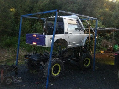

Mattrade
Posts: 386
Post by Mattrade »

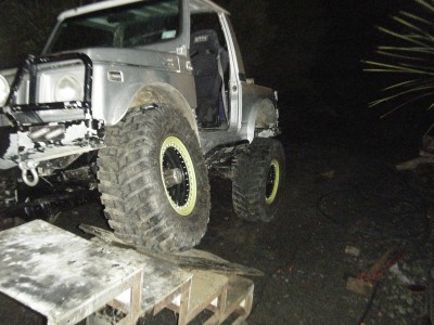

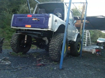

Testing out the flex, with new axels.
